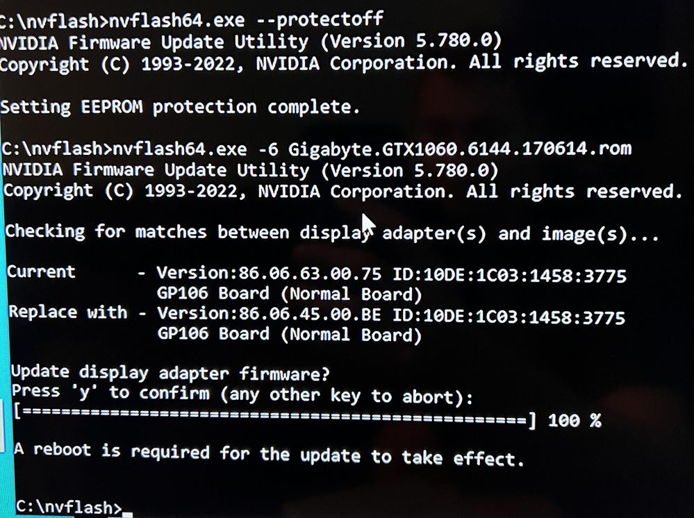

After searching a bit, it seems updating the Vbios would fix the boot issue.
Find your gpu part number and match it, then compare vbios versions, hopefully there is an update for you.

Thank you for your response. I searched for my card's (GV-N1060AORUS-6GD) vbios and downloaded this vbios file (Gigabyte.GTX1060.6144.170614.rom).
I then disabled the video device in "device manager" and ran nvflash:
96019
One thing I noticed is the new bios version seems "older" than the original? I proceeded with the flash and then it asked me to reboot the computer to finish, I then went to Start->Restart in Windows and experienced the same issue with no video signal to the monitor. I waited about 5 minutes and then held the "Restart" button on the case. After booting, I enabled the device again in device manager and again did, Start->Restart in Windows. Same issue. 😞

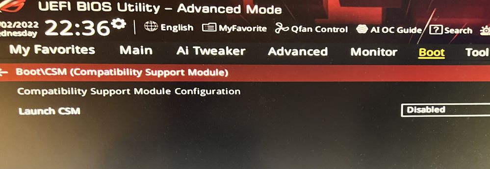

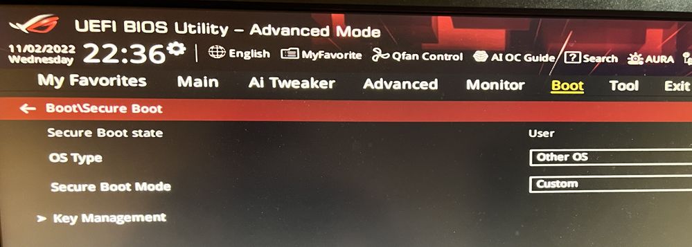

Try this:
In the bios on the boot tab, try disabling CSM and set Secure Boot to Other Os.
If that didn't help, try this Nvidia firmware update.

Hey Nate, thanks again for your reply. I ensured the BIOS settings were the same and also tried the DisplayPort firmware. I still experience the same issue. I've also tried using HDMI cables and that hasn't changed anything either.
96033Â*
96034
96035
I'll try any other suggestions. Unfortunately I don't have another video card to try but I can confirm the card works perfectly in another build with the same monitor and display port cable. Again this feels like some sort of "handshake" issue between the board and video card, maybe could it be a BIOS firmware issue even though I'm on the latest one?

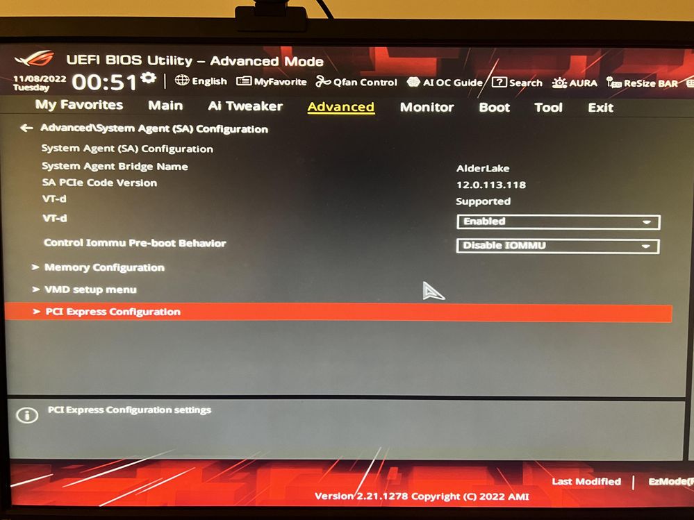

Maybe it's something with the integrated graphics? Find inside the BIOS the Advanced tab and locate System Agent SA Configuration menu. Look for Graphics Configuration menu. Inside you will have Primary Display. Switch to PCIe. Go back and for the iGPU Multi Monitor menu, switch to Disabled. Save & reboot. Let us know what happens.

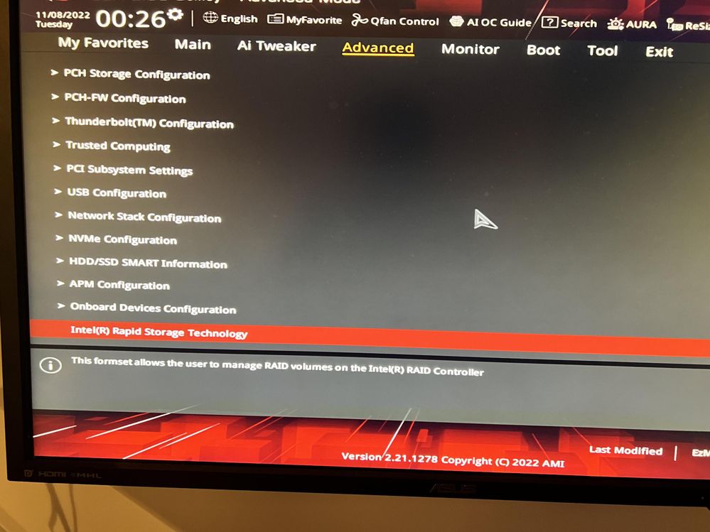

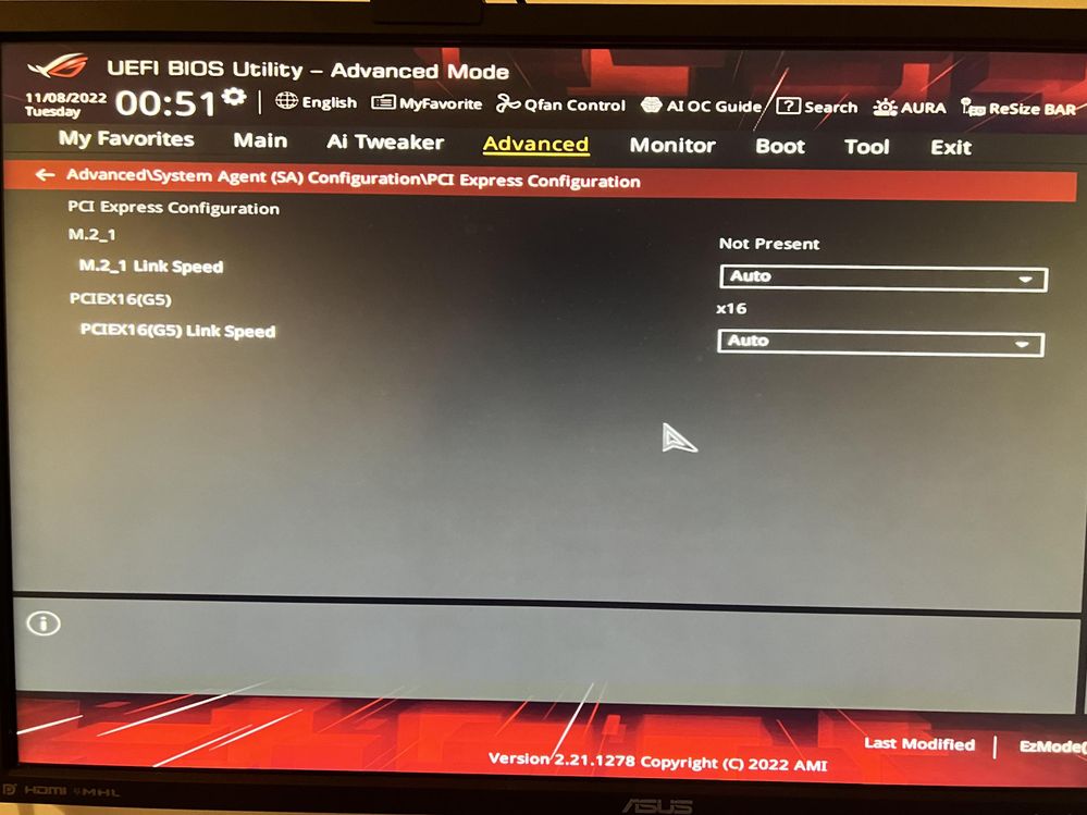

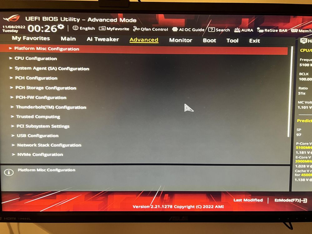

Hey @AS185, thanks for the response. I looked in System Agent Configuration menu in my bios and didn't see anything related to integrated/onboard graphics. I looked through all BIOS menus again and didn't see anything similar there either. I was really excited after reading your post because it makes sense a setting like that would cause the weird symptoms I'm experience with power on/reboot and losing signal.

Two more specifically showing which System Agent (SA) Configuration options I have

Man, you don't have Graphics Configuration displayed inside the System Agent Configuration. Very interesting.
Ok. De-attach the GPU from the PC. Plug in the HDMI cable into the back of the motherboard and fire up the computer. Load into the BIOS and locate the Graphics Configuration. Make a screenshot man.
