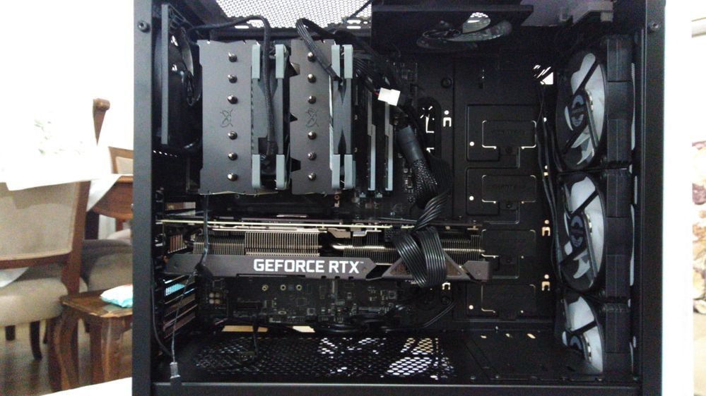

This is BEFORE I gave the card to the RMA service. Yes, the card is sagging but that is only because I removed the sag holder before taking the card out, the card was always used with a sag holder (and sagging cannot bend the PCB anyway.), and in another picture you see it with the holder too.
The card was perfectly straight until the RMA damaged it.
