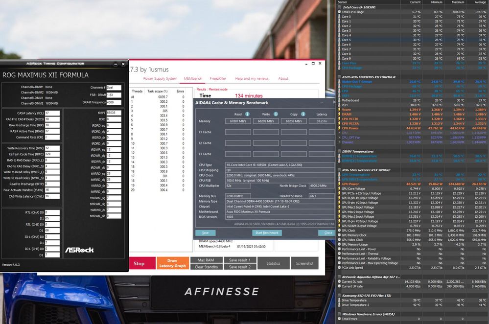

With the same kit but back to my old sp79 10850k CPU I can run 4400c17 stable without any issues.

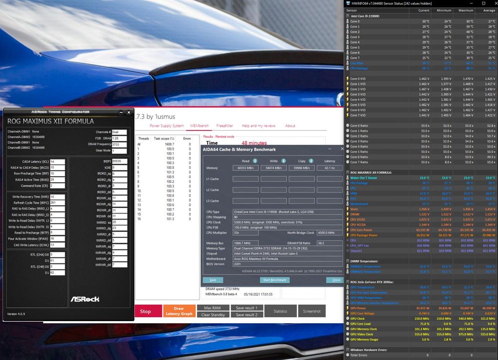

Here is what my 3733 g1 is looking like at the moment couple more values I can possibly decrease with TRTP/Twrrd_dg
88709

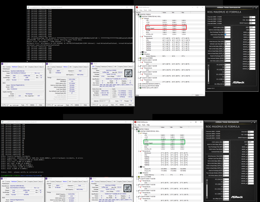

Here is an example of excessive VCCSA causing instability. The only change is the increased VCCSA. Memory training is a harder pass than operating system style tests because the requirement falls down to a pass/fail. When exploring highest obtainable frequencies these changes are more important as the margin for error on an electrical level is much smaller.
Admittedly I haven't used this platform much, but these rules are universal depending on the architecture. Moreover, VCCIO shouldn't be far too out of spec from VCCSA, this is also comes down to an alignment issue when overclocking.
I would look to dialling back on these rails and try and dial back on terts and seconds where possible. Some of those rules can still be quite tight for a given ratio even in auto. This is by no means guaranteed to work, but may keep you on the right path. The strength of the memory controller still needs to be considered.
You may wish to aim for your maximum obtainable frequency at CR1, too.
88724

Thanks for your response however I believe my screenshot has shown this working perfectly fine with a mem test as well for 3733, I can also show you it working perfectly fine with 4400 on the same motherboard/ram if you want just a different CPU 10850k previously.
While I understand the CPU is different and IMC's can be different I believe this is more down to the bios support for the 11900k and mine is of SP85.
Hoping something Shamino/Safedisk can turn their attention to and support.

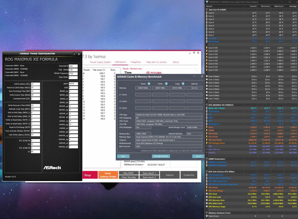

Here is another screenshot of even further tightened secondary and tertiaries running stable at 3733 gear 1 with a successful pass of memtest.
88722
