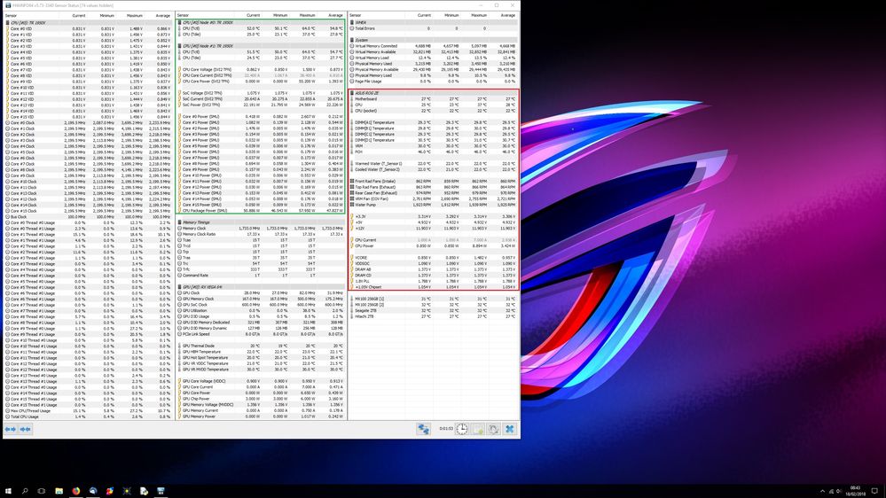

Anything that needs to show a voltage, temperature, etc (ie related to CPU/RAM/VRM, the "platform") is accessing Super IO chip. In HWINFO whatever is under ASUS ROG ZENITH EXTREME (ITE IT8665E) and ASUS EC is all from Super IO chip. So any other app that accesses any of the same info is accessing Super IO chip. In my setup everything in red is Super IO chip, green is CPU SMU AFAIK.
71724
ITE IT8665E is the Super IO chip used on ASUS AM4/sTR4 mobos.
