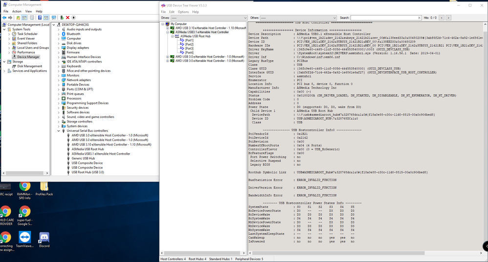

I changed back to 1701 bios and updated the drivers using the link you supplied.
I still have a problem tho.
The system is acting like it doesn't see the port anymore, none of the red ports on the back of my system, not the usb c and not the usb a port work anymore.
This is after running that usb update on the downloads page, I think the firmware flash went bad or something.
I plug items in that would light up on other ports and the item doesn't light up on the red usb 3.+ ports. I have no problems with any of the blue 3.0 ports just the red 3.+ ones.

As far as I can tell something is wrong with the device. Is there a way I can attempt a reflash of the firmware?
I tried to run that firmware update tool again and it just errors out.80361

What are your XHCI settings?
