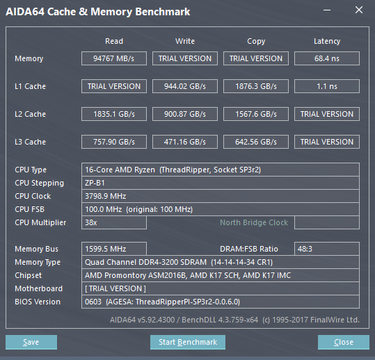

EDIT:
OC'd the cpu to 3,8GHz, swapped to NUMA mode and this is the result:
(just to show how it is possible to get higher results)
67702

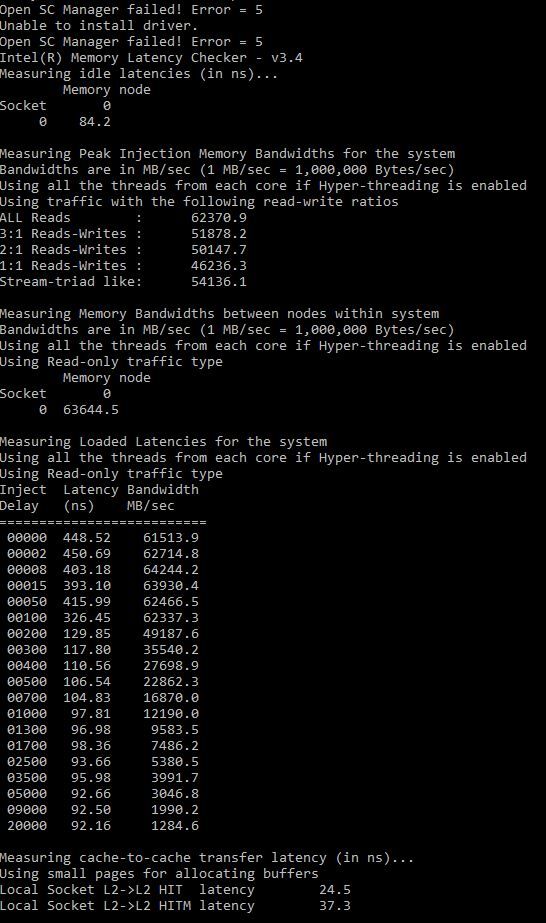

Just curious, what values do you get from Intel Memory Latency Checker?

Here you go:
67759
