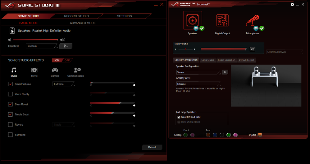

I'm using the Maximus IX Code but the Realtek driver should be basically the same unless you have a newer version, for me it also installs Sonic Studio 3 and Sonic Radar 3.
I'm using the Plantronics Gamecom 380 headset and it sets it to Extreme for me too and I'm not getting crackling. If I connect them to the front case jacks it sets it to performance, you could give that a try it should still sound good.
I'm sure you've tried the latest Realtek driver from the ASUS Support Center.
Version - V6.0.1.8210
https://www.asus.com/us/Motherboards/ROG-ZENITH-EXTREME/HelpDesk_Download/
Here's what mine looks like, click it to make it bigger.
67880
