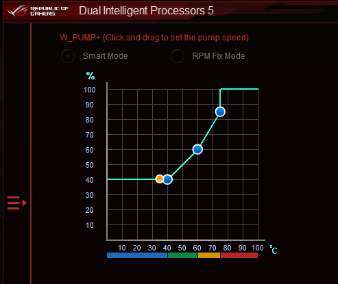

So i have my Ek pump plugged into the W_Pump Header on Maximus XII Hero board and i set it up on the bios,
But it keeps reverting back to 100%
When i look on Dual Intelligent ROG Software the pump profile line matches the bios settings, but the pump displays as full load until i slightly adjust the curve and then it starts to follow what i set.

BPortelli
this is what its doing on app, temp low and should be on the set line, but is running 100%

Well, I got mine "fixed" but I am just a tiny bit unsure of what I did. I made a variety of changes in testing then it started working. I'm going to lightly blame either Aura Sync or AISuite3.
I went into BIOS qfan (F6) and tried to change w_pump+ and it would not accept anything other than 100. So I set the mode to "Auto" under W_PUMP+ header. I had uninstalled Aura Sync and G.Skill KM780 software as those were the most recent changes.
In DIPS5/FanXpert, I ran the "Fan Tunin" and it still wasn't registering speeds on W_PUMP+ header. Then I scrolled through the different headers in DIPS5 and then clicked on W_PUMP+. I set a curve and hit apply and it worked! This same path had not worked when I made my post earlier.

Well well well. It worked for about a day....Now my pump is back to running 100%. I had put the computer to sleep and woke it up this morning and now pump is full speed. Worse in DIPS it *looks* like it should be running lower, as the yellow ball moves. However, no amount of changing the curve adjusts the motor.

I went into BIOS under the Monitor tab. Went by all of the monitoring lines into the QFan area (don't use F6). The W_PUMP/AIO was set to auto mode. I switched it to PWM mode. (This is making me wonder if toggling the W_PUMP mode some how "sets" it back to what it needs to be.)
Booted up and opened DIPS5 and FanXpert. Noticed the W_PUMP was now set to a straight line at 100%. Pulled the dots and created a curve, hit apply and the pump slowed down!
