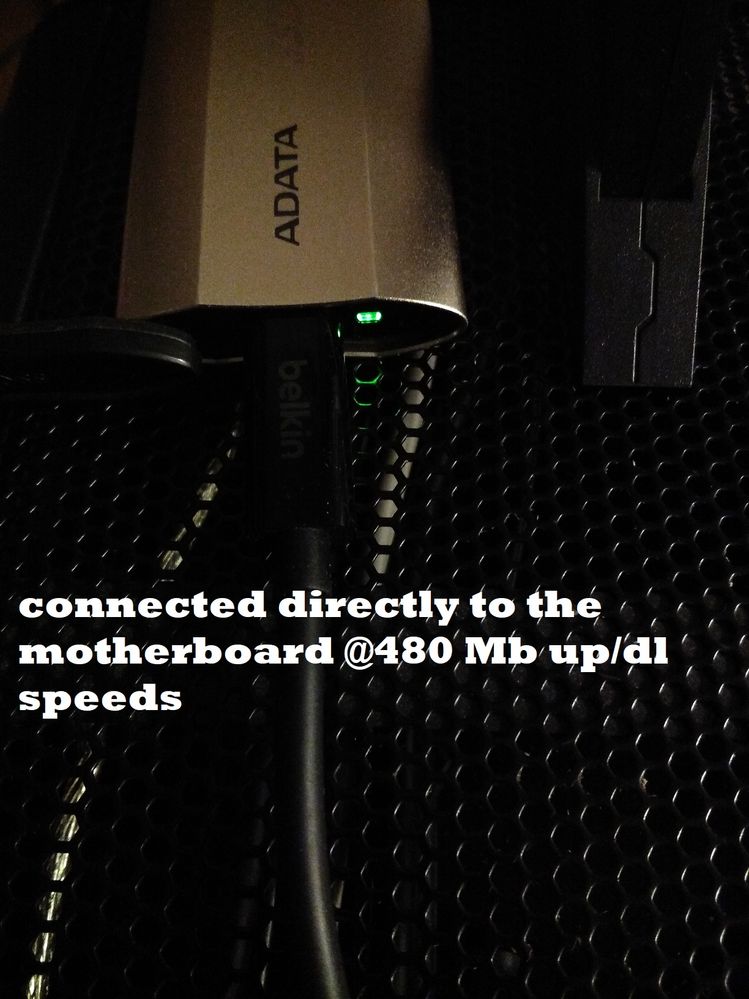

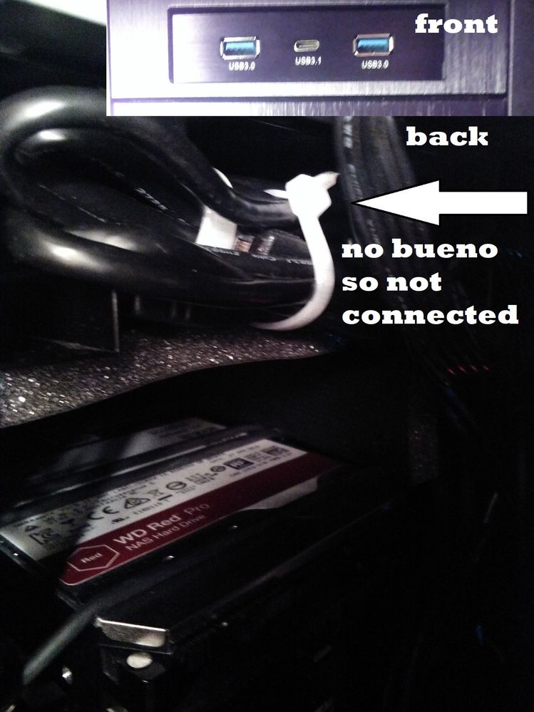

Here is mine:

I use a USB 3.1 cable to the motherboard now:
74746
