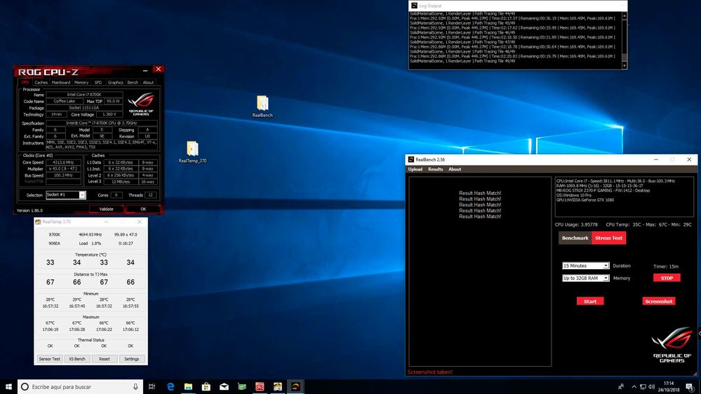

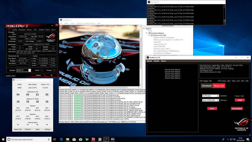

everything is not over 67ºC. Stress test for 15min. I do not step 2.368v
in the catch all
76502
this after the test the vcore oscillates the voltage a lot
76503
76504

I am 99.99% sure your voltage sensor is faulty. Those temps are consistent with 1.28 - 1.34 volts on the CPU at 100%.
Since you have changed BIOS twice now - correct? - I am not sure what else can be done besides narrow down where the sensor fail is.
CPU or Motherboard.
To test this do you have access to another motherboard, possibly if you put your CPU in a friends system and see if the same error in voltage reading occurs.
