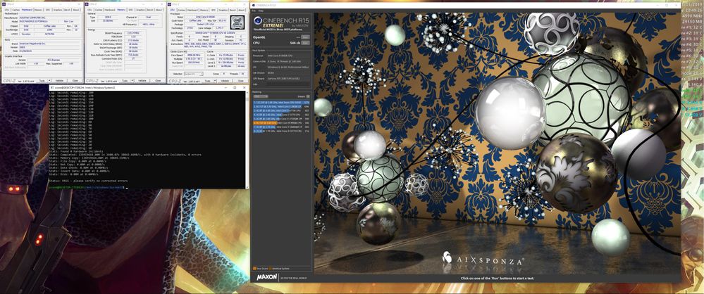

Took a while, but I sourced that kit.
F4-4266C17Q-32GTZR on Formula XI @ XMP (1 Hour of Stress App Test)
79337
