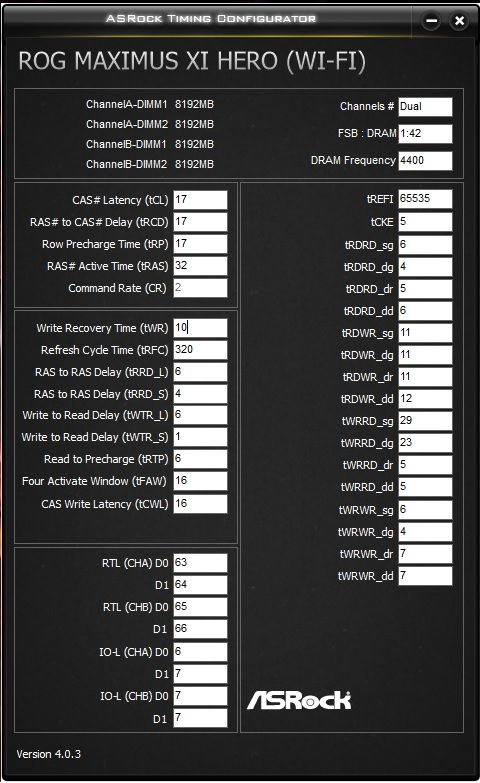

Overthrow
What is the difference between mode 1 and mode 2?
Mode 2 set the RTL/IOL faster, it´s more difficult to boot this, on my Wifi XI i get Mode2 stable to 4x8GB4133hz and Mode1 4400Mhz.
So ever use Mode 1 by 4Dimm, for high Frequency stable by 4 Dimm you Need a good CPU, also good Ram.
Most important i Think is the IMC of the CPU.
With 4x8GB 4266CL19 GTZR i have reached Allstable 4400CL17-19, with Patriot 4400CL19 Allstable 4400CL17-17 with Sub´s 65.5k 35,4ns.
The Board is also important tested 3Wifi XI only one Board have done Allstable 4400, one 4350, the first one was bad issue Socket.
Here you have Timings this is with Mode1 RoundTrip Latency on RTL/IOL Auto, easier is Mode1Offset 16/16 or 18/18.
83180
