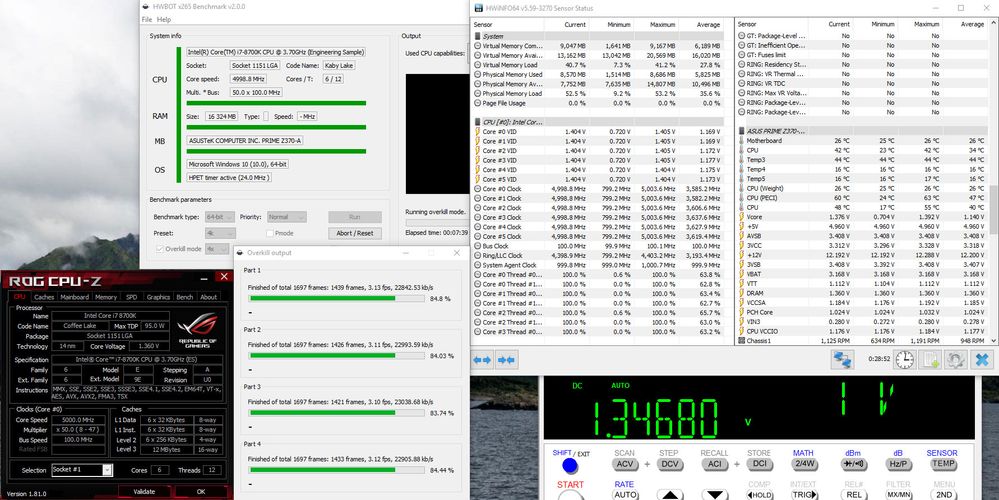

Praz
Level 13
Hello
SVID control does work. The result is dependent on Intel's programmed voltage algorithms and correctly set associated BIOS settings. Voltage reported by software can be off 0.030V or more as well.
68466
