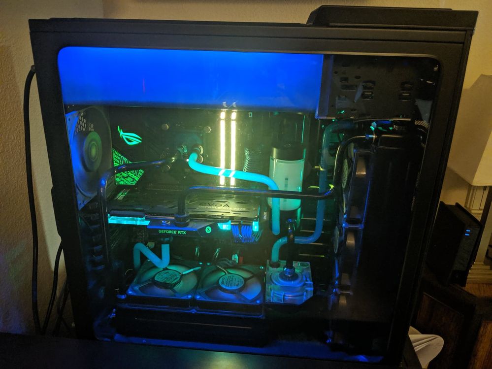

So I have spent the last two days trying to figure out why my new upgrades would not post when XMP or XMP2 profile was loaded.
Specs: BIOS 1105, 9700K, Z390 Gaming E, Corsair RGB Pro (32GB 2x16) 3200MHz Kit (Second Kit, I exchanged the first)
What I have found so far.
- If both A2 and B2 DIMM slots are populated the default memory profile works fine (2133Mhz); if I enable XMP or XMP2 (3200Mhz) it fails to boot no matter what.
- I have tried to manually adjust several of settings from DRAM Voltage/Timing, VCCIO, and Sys Agent voltage and nothing will work.
- If I install either stick in A2 slot, it posts find with default and both XMP profiles.
Kind of at a loss here right now. I have seen other say that a cooler block can be over tightened and cause poor connections or bent pins....but would that not just kill the DIMM Socket completely, or is there extra traces to handle the higher speeds? I will inspect the DIMM Slot tomorrow, maybe loosen the CPU block, or pull it to inspect the pins on the socket. All depends on why kind of feedback i get. Also, would A1 and B1 able to support the XMP profile to determine if the B2 slot is bad?
Any help would be great.
Edit: DIMM Slot B2 looks good, no push or bent pins. I need to verify what DRAM Freq I was capable of posting from manually changing it. I think I started to see issues around the 2800Mhz area. ** Failed Post, retried and posted to a MEMOK notification telling me to go to Bios and save settings**
Edit 2: Manual DRAM Frequency adjustments.
- 2666 Posted no problem
- 2700 Failed 1st Post, passed 2nd post and was prompted with "MemOK" save Memory settings in Bios. Saved, restarted, and posted on restart. (DRAM Voltage was 1.350)
- 2800 Failed 1st Post, Passed 2nd post and was prompted with "MemOK" save Memory settings in Bios.Did this restarted and posted on restart. BUT I saw the DRAM Voltage jump to 1.510, so I stopped till I got some more insight.

Kritikill
I appreciate you reaching out, I am just not sure I have any clarity from what you have said. I understand that the XMP's are not guaranteed to work in every situation. At my experience level(low) I would have thought that I could have dialed it in using some basic changes to voltages and timings. It seems like further settings could need adjusting, and I just dont know how they affect the stability. i.e. at what point would you adjust timings?
I am also confused about the difference between standard VCCIO and SysAgent Voltages and separate BOOT Voltages that also have VCCIO and SysAgent Voltages. Could the boot voltages make a difference in getting it to post?
I have tested both sticks of RAM, one at a time, in A2 and B2. The results were as follows;
A2 - Single stick(Both), Posts with Default 2133Mhz(JEDEC) settings and XMP 1 profile
B2 - Single stick(Both), Posts with Default 2133MHz(JEDEC) setting and NOT XMP Profile
A2 and B2 Populated, Posts with Default 2133MHZ( JEDEC) setting and NOT XMP Profile. Can push to 2800MHZ, but DRAM Voltage climbs to 1.510v. Is that too high? Any more headroom?
I have seen some guys talk about bad traces or bent pins on the socket...just a lot of work to tear down my loop(Rigid) and look. So I if I go that far to look may as well exchange it. I bought from Best Buy, and they have a 15 return policy, may return the Mobo and CPU to eliminate them.

Kritikill
I appreciate the time you have taken to help out. I exchanged the CPU and Mobo this afternoon, and have them installed. I powered up and no problems getting XMP to take. I would like to think that the CPU had a weak IMC. Guess i will never know lol.
