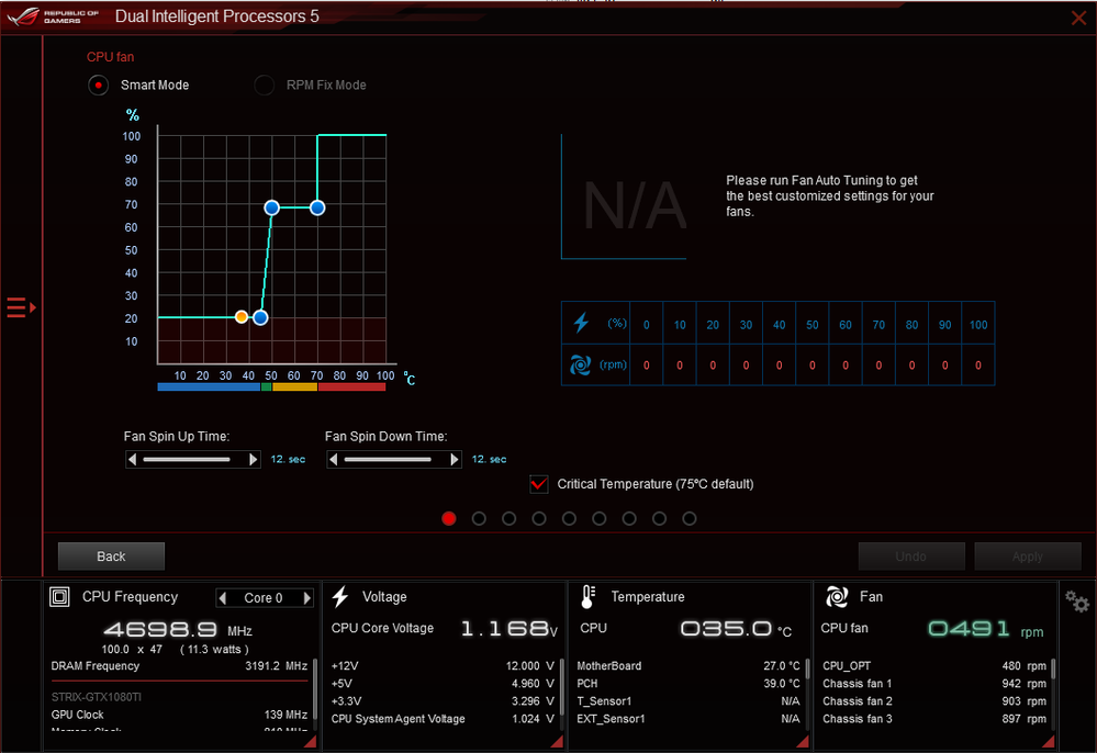

In Q-Fan and AI my DC-powered case fans cannot be lowered enough. Why not?
I run the automatic fan calibration. Afterwards I can reduce the CPU PWM-setting lower to 10%. Thats really nice. But what about the DC-case fans. Their settings can only be reduced to a point/voltage above the fan starting voltage!?!?! So the case fans turn with min. 500...600rpm at idle. For me it is too noisy. The fans runs very nice below their start voltage too.
I hope Asus will let us have a better solution for fan control.
At the moment it is not a big problem for me, because I use the good old program from Almico "Speedfan". It handles the Nuvoton chipset perfectly, and I am able to control all fans, also beneath the AI Suite and Q-Fan settings. The fan speeds can be controlled depending on the GPU-temperature too with Speedfan. Thats would be a great point to add into the AI Suite.

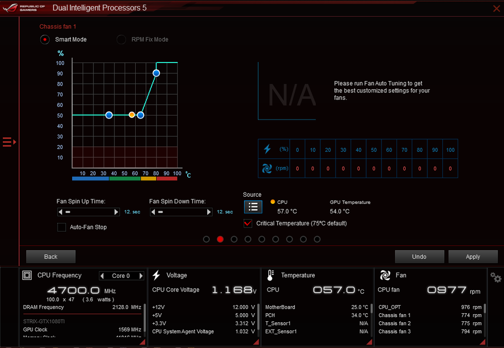

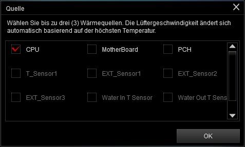

AI Suite already supports that. Click on Source
70151
Well, why don't I get this option for my GTX 1080? Is it because my card is from MSI, or do I have to change a setting? 😞
70153
I suppose I have to get a Strix 😮
