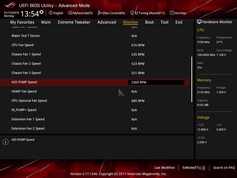

The problem is if I cut the power via the PSU power button, at next boot the AIO pump will work in silent mode (low rpm).
I have to start CAM software to make the pump operate at full speed. If I do not cut the power from the PSU, the pump will retain it's settings.
At least for my build, the pump speed makes quite a difference in CPU temperatures so I would like to run it at full speed all the time without CAM.
I am not 100% sure if Kraken X62 pump can be controlled via the AIO pump header on the MB or only via the USB header, but the rpm readings from the MB are a bit strange. Might be the reason why the pump does not run at full speed after a a PSU shutdown?
In BIOS I set the AIO pump to run at 100%.
Values after I start CAM once and I do not cut the power from PSU
BIOS show 5500+ rpm while the max speed of the pump is ~2.700 rpm
70571
HWInfo shows ~2.700 rpm
70572
Ai Suite also shows 5500+ rpm
70573
BIOS values after I cut the power from PSU.
Pump is in silence mode now (~1200 rpm), but BIOS shows it is running close to max rpm.
70575

BIOS and AI Suite report ~2200 rpm for AIO. Meaning the pump runs in silence mode (low rpm)
HWInfo reports ~1100 rpm.
Started CAM and the pump went full speed @ ~2700 rpm
As far as I can see BIOS sees double the real rpm of the pump and does not make the pump run at 100% even with Q-Fan disabled.
Might be an incompatibility between Kraken X62 and X HERO, at least in the way the MB reads the pump rpm.

Unplugged the AIO USB from the MB and now the BIOS does not show any rpm readings.
I guess Kraken X62 needs the USB for powering up the pump and the AIO pump plug only reports the rpm but does not allow controlling the speed.
I think I have miss understood the way I can control this AIO.
I was under the impression that the USB was only for controlling lights and reading liquid temperature. But it seems I wrong.
later edit: just found a blog post from a NZXT rep. saying: "the cable running from the pump to the CPU_FAN header only reports pump speeds. The actual readings are being reported via the USB cable."
Nevertheless, if anyone knows a way to make the pump speed go 100% all the time without CAM software, please share.
