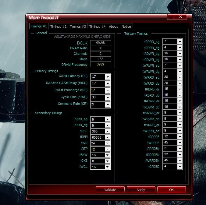

Hi guys, I recently bought the new platform with the following ram https://www.gskill.com/en/product/f4-4266c19d-16gtzr i managed to make the system stable to 4000 mhz, but i can not start at 4133mhz with bios 0505, with previous bios 3866 maximum limit, after 4000 easy boot upgrade.
For the moment I set the bios:
50x sync all cores
adaptive voltage 1.31v
llc 5 level 5
Set IA AC Load Line to 0.01
Set IA DC Load Line to 0.01
Cpu c states enabled
Vdram 1.45v
dram 4000 frequency
vccio 1.2v
vcsaa 1.2v
tweak mode auto
primary timing, @Raja tips for pe 4133?
17-17-17-30
If I imposed cl 16 not boot, RAJA@ASUS tips?
Sorry for my english, i'm italian;)

If it won't post at 4133 you may need the exact 4133 timings, which I happen to have as I have the 4133 kit.
Would you do me the favor and then send me the SPD info from your 4266 kit? Use Taiphoon Burner from http://www.softnology.biz/files.html to read what your SPD says (I'd like to have all the timings to OC my kit 100% identically to the 4266 sticks, not just the first 4 popular ones).
