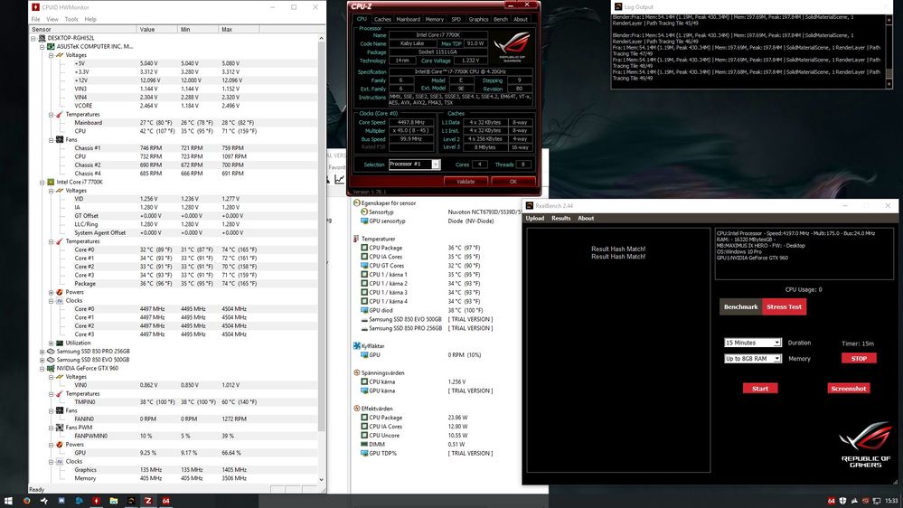

I read all over the WEB that setting Voltage to auto is BAD.
and since i am totally not a Tweaker (yet) I decided to go here and ask.
I will provide an image showing how my temps and Voltages looked after running the ASUS ROG RealBench Stress test for for 15 min.
Does my Vcore look normal?
Temps to me seems fine?!?
Any aid is helpful.
/JeRok62811

Temps and voltage look good and it's true on auto your cpu is getting over volted some.
You can try getting the voltage lower if you like this will lower temps even more but isn't necessary. For every day use and gaming max temp is 64c, for stress testing your temps are fine.
To get temps lower set the cpu core/cache voltage to adaptive, enter in 1.230v in the "Additional Turbo Mode CPU Core Voltage" then use a negative offset, It's trial and error so start with say a negative offset of - 0.030v, this should put your cpu voltage at 1.20v when under load. If it's stable keep lowering the voltage in 0.010 increments so next would be a negative offset of -0.040v which should put the cpu voltage at 1.19v when under load.

Temps in the low to mid-70's under RealBench load is actually very good.
Obviously the 2.49 Vcore being reported by HWMonitor is not correct. CPU-Z is usually more reliable and accurate.
I suggest monitoring the CPU-Z Vcore while under RealBench load to get an idea where it peaks. 1.232v at idle is normal at default/auto.

Hello again and Thank you for all the replies.
I am very happy with the U14S looking at the temps I get with fans not blowing on max.
I did a new test and decided to make a screenshot during the stress-Test when the stress was on the 14th minute.
To me the Vcore set by the ROG Hero and ASUS is spot on?
