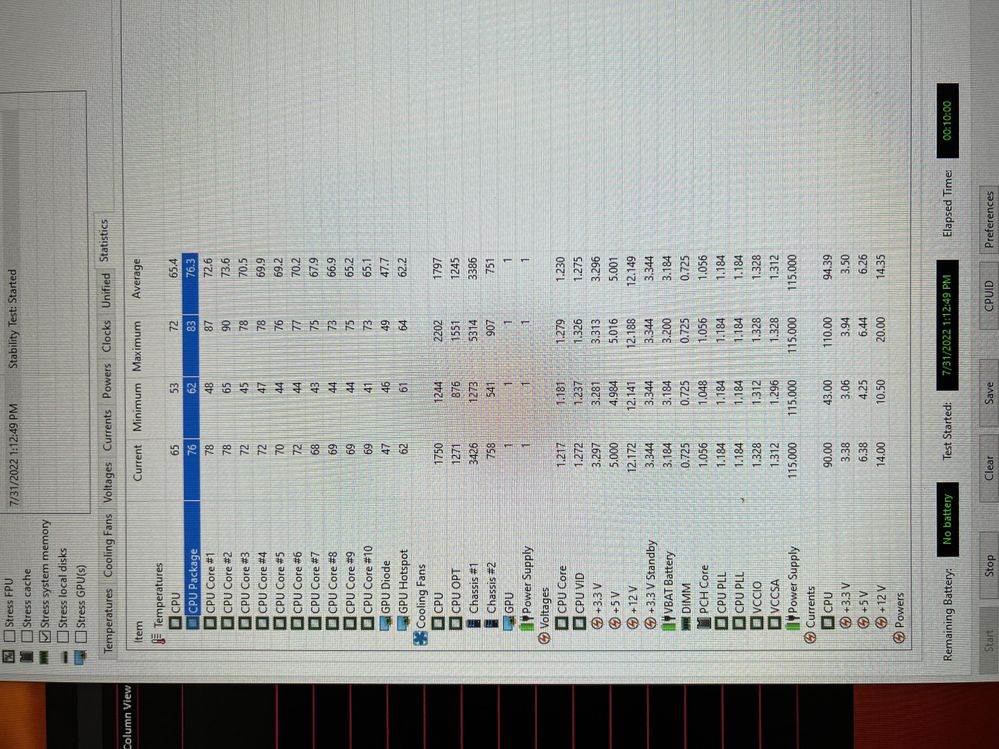

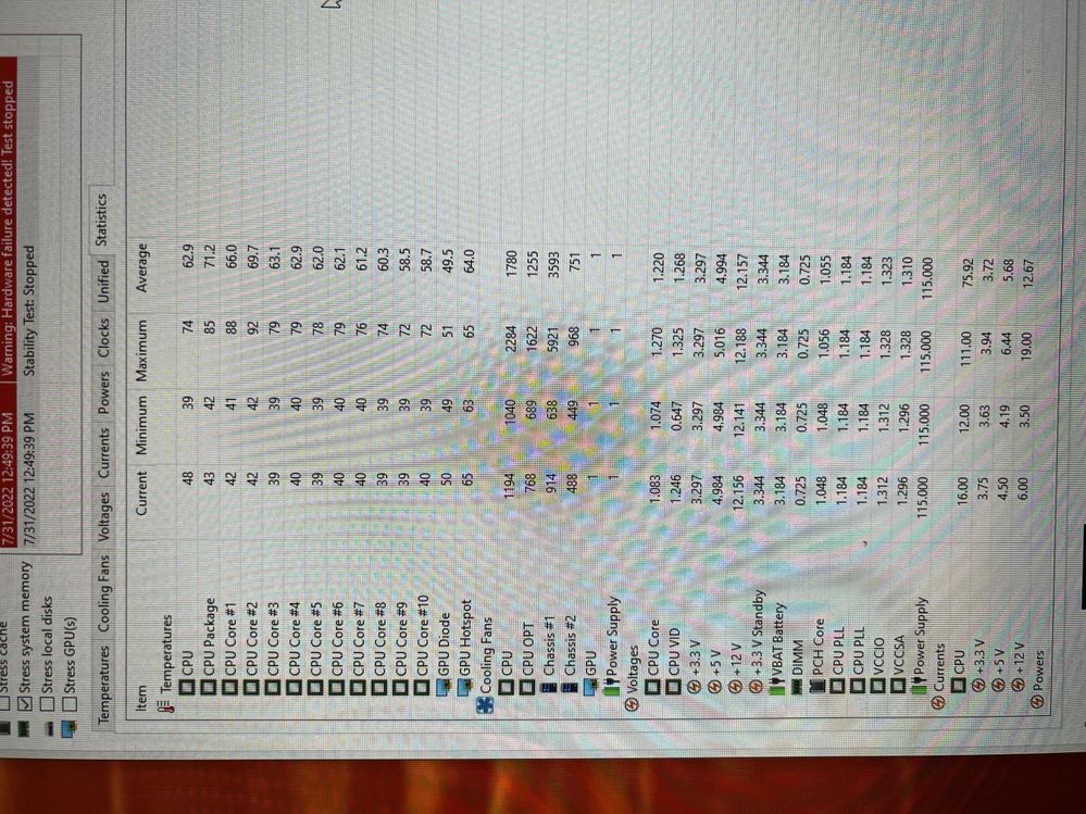

she booted up with both kits but failed the stress test, but it looks like cpu temps by what i figure, what do u think?94337

in asus suite 3 i have my cpu temp threshold at 85. so maybe thats why its failing. im water cooled with a 320 radiaor and 3 fans on a AIO. i think this processor runs on the hot side, maybe i need to bump my threshold?

CPU Core 1 and 2 look on the warm side.
Let's see how far you get with all four sticks starting with 3600MHz.

3900mzh i ran it another 10 mins afte that and temps are the same just took forever to upload. i bet my threshold is shutting it off and failing the test. i think this thing said 95c is max or something like that. maybe i can tweak my fans?

You could try turning up the fans, cores 1 and 2 are running hotter.

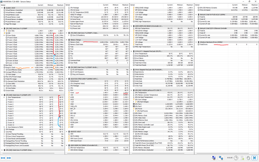

I can use up to 1.474v on the i7-12700KF and have acceptable gaming temps, this is with a 560mm radiator.
Click the pic to make it bigger
94340

what do u use for stress test? is it this hwinfo64?

Yes it's Hwinfo64.
I haven't run a stress test as I know temps will skyrocket over 90c.
AI Suite reads the cpu socket temp which is what your motherboard led's are showing, not the actual core temp.
