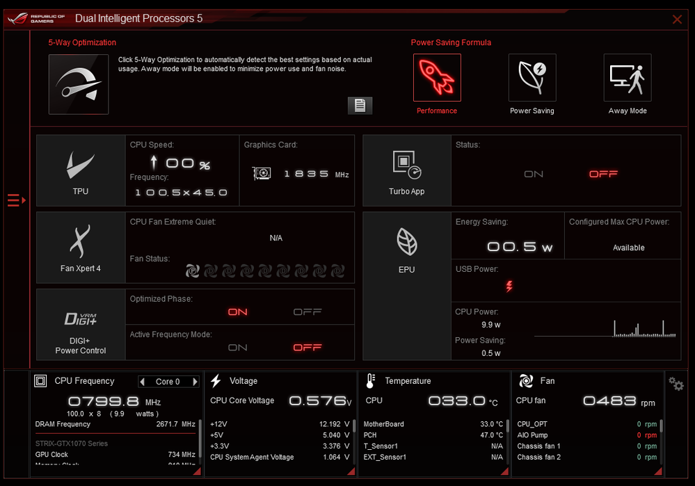

Since we’ll be using the DIP5 functionality to overclock our processor, we will need to open AI Suite III. You will notice four panels located at the bottom of the utility which constantly display processor frequency, CPU Core Voltage, CPU temperature and fan speed. This is helpful information which will aid us in our overclocking endeavor. So let’s click the 5-Way Optimization icon to commence the DIP5 process.

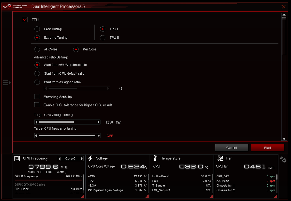

Most of the settings can be left alone. Only the Target CPU Voltage tuning option requires your attention. I would recommend 1.35V as the maximum value if you’re using a high-end air cooler, 240mm AIO liquid cooler, or better. For anything inferior, I suggest a value between 1.25V to 1.3V. Don’t forget to take your ambient temperature and case airflow into consideration as well. If neither is optimal in your situation, consider using a lower value than what's suggested here.

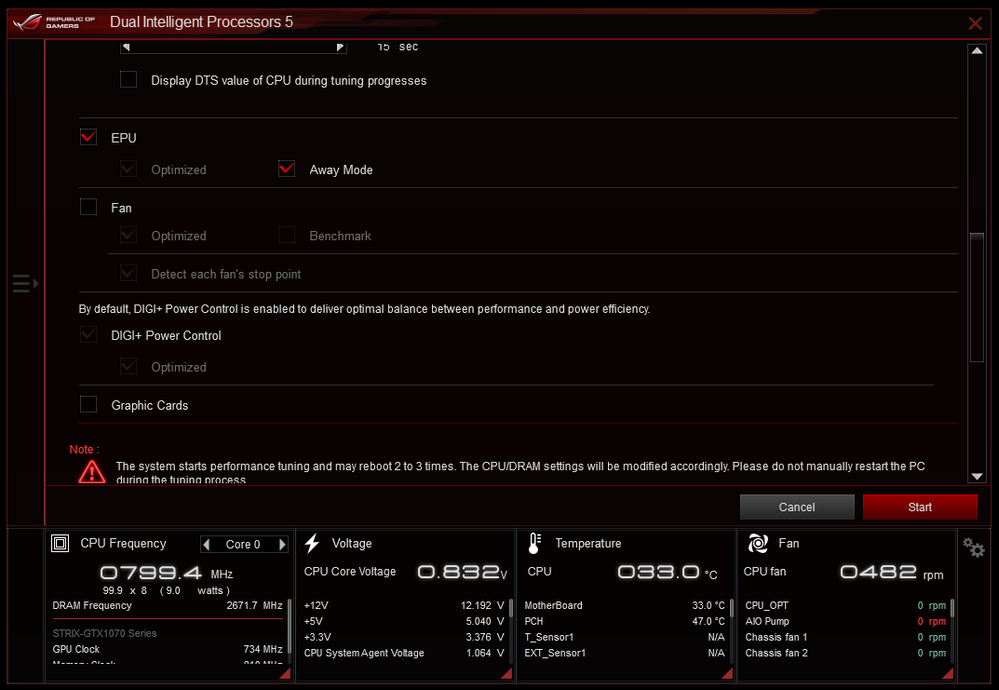

We need to scroll down to uncheck a few more options. By default, AI Suite III will tune your fans and graphic card. If you’re focused on the CPU, you can untick those options. Leaving them ticked will add unnecessary tuning time to the overclocking process.

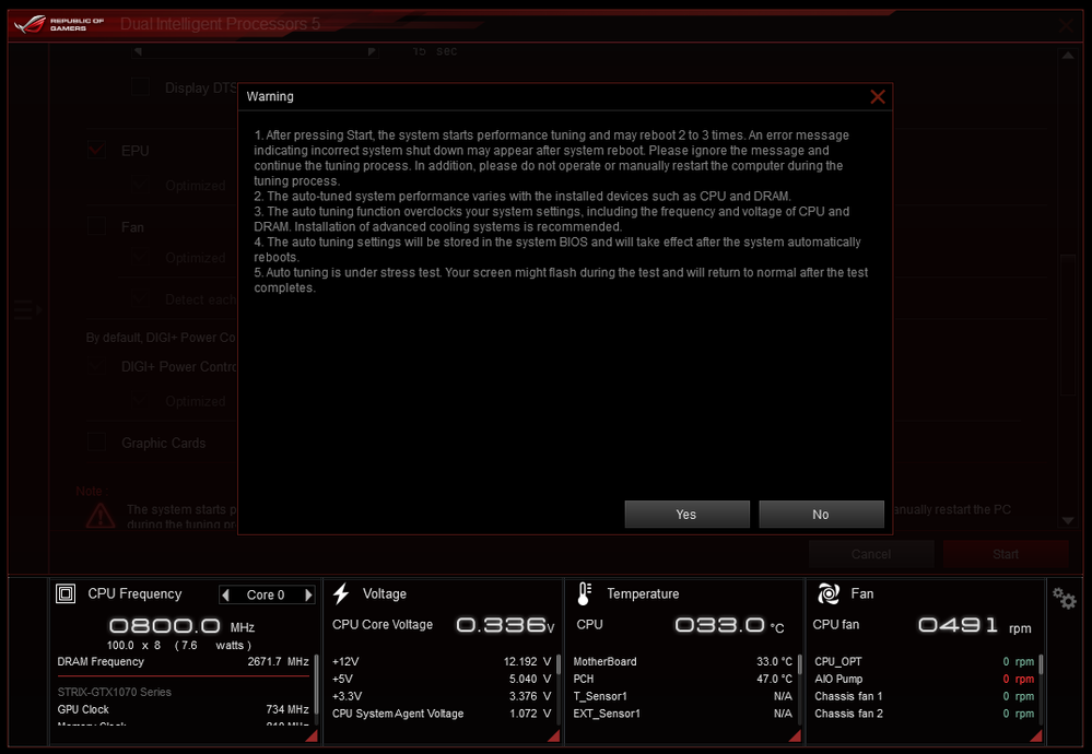

Once we’re done configuring the options how we like, we can proceed to pressing the red Start button. A new window will pop up describing the whole DIP5 process. Press the Yes button, and the system restart to initiate the DIP5 tuning process.

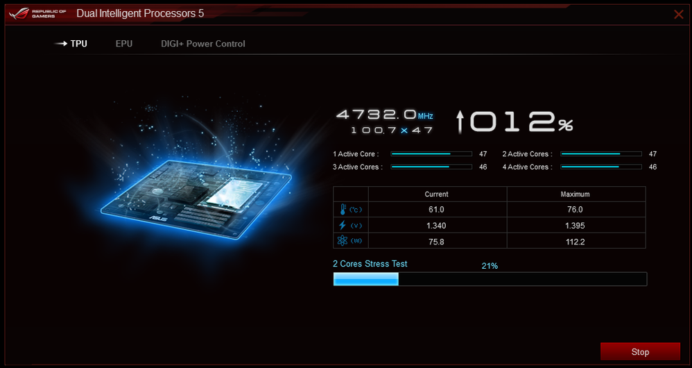

At this point, DIP5’s built-in algorithm incrementally raises the processor’s frequency and core voltage while testing stability along the way. Overclocking results vary depending on the potential of your individual processor and the performance of your cooling system, so this is the best approach to finding the highest attainable frequency for your specific combination. Sit back and let DIP5 do its thing.

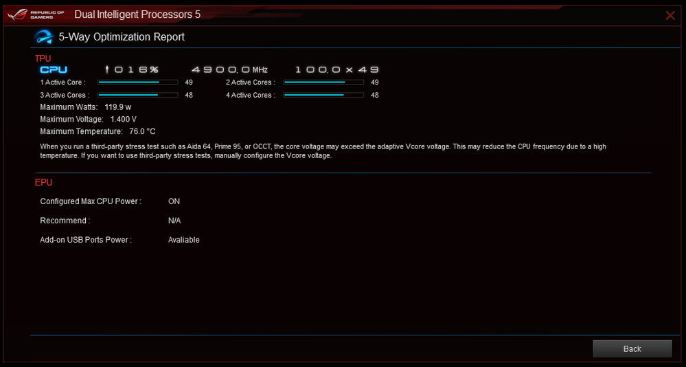

The entire tuning process typically takes less than 10 minutes. However, it can take longer if you let DIP5 tweak other aspects of your system—or if you extend the duration of the built-in stability test. When the process is completed, DIP5 provides a detailed report. It successfully pushed my CPU to 4.9GHz with one or two active cores and 4.8GHz with three of four active cores. Processors are typically capable of running at higher speeds when fewer cores are active, and DIP5 takes this into account by default.

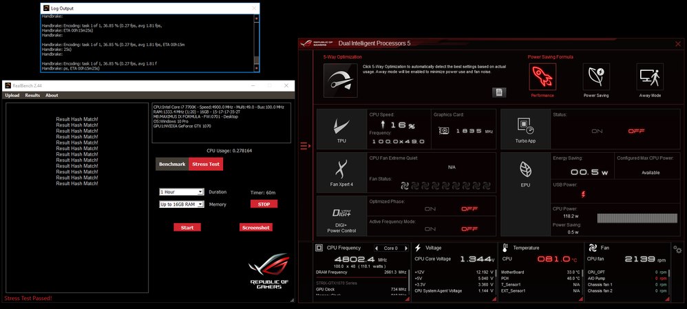

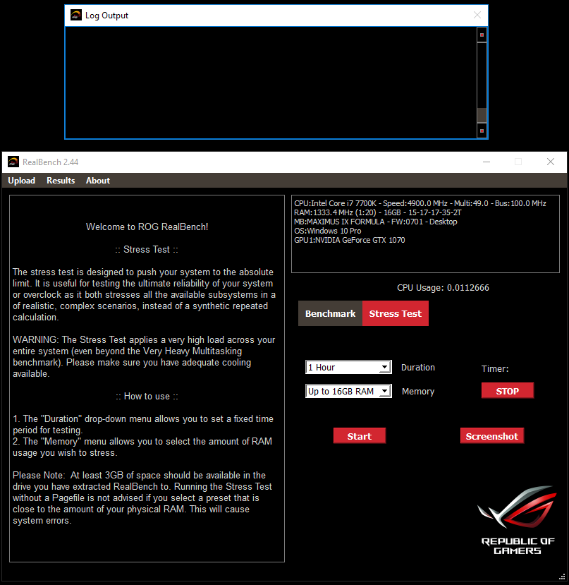

Everyone has their own preference regarding which software is best for stability testing. So, by all means feel free to use the one of your choice. I prefer ROG Realbench over other alternatives because, unlike most stress tests which put a synthetic workload on the system, Realbench uses real-world applications instead. In most situations, running Realbench’s stress test for two to four hours is a good indication that your system is stable for everyday usage. However, I only run it for an hour and call it a day. The rest of my stability testing is done outside the program with real-world usage. When you’ve chosen your desired duration for the stress test and the amount of memory corresponding to your system, press the Start button.
62647
It is important to monitor the processor’s temperature during the stress test. Ideally you would want to keep it below 80C. But there is no need to be alarmed if it’s slightly higher. Few of us run our processors at 100% utilization for prolonged periods of time. You should see lower operating temperatures in normal daily usage. As a preventive measure, you can monitor your processor’s temperature while using the system as you normally would.

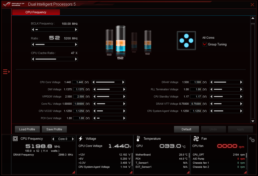

Inexplicably, the one from included flash drive works. They are the same version but that one works. DIP5 pushed my 7700k to 5.1Ghz on a 420mm custom loop.

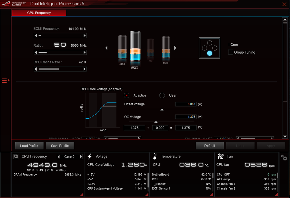

I don't remember what all settings I chose to run it at, but this is what I ended up with:
66025
While watching DIP5 "do its thing" I saw that it went to 5100 MHz and found an instability and then it dialed itself back to 5050 MHz and retested and finalized at this OC. Pretty cool. 😉
