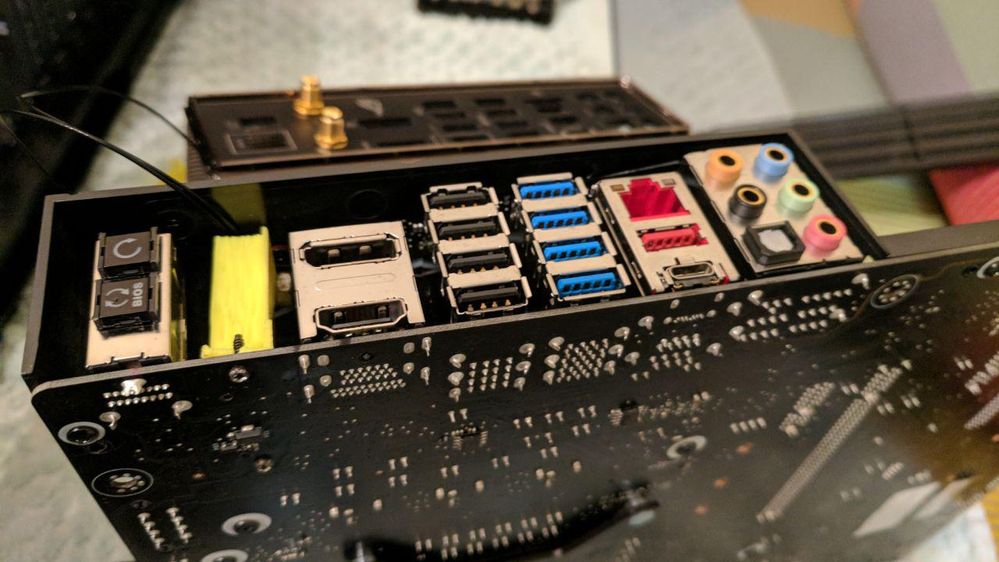

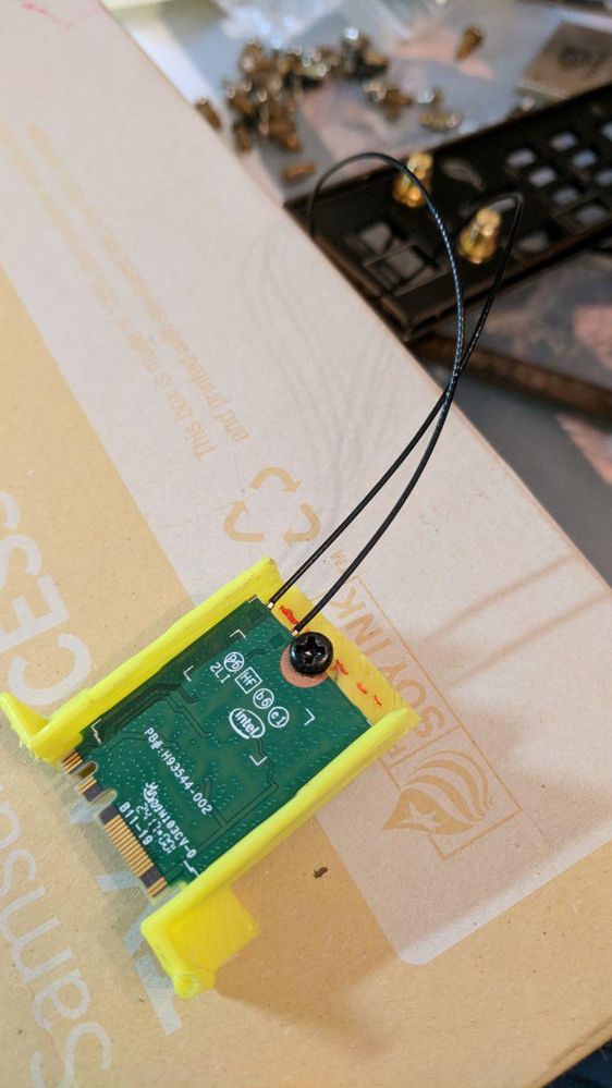

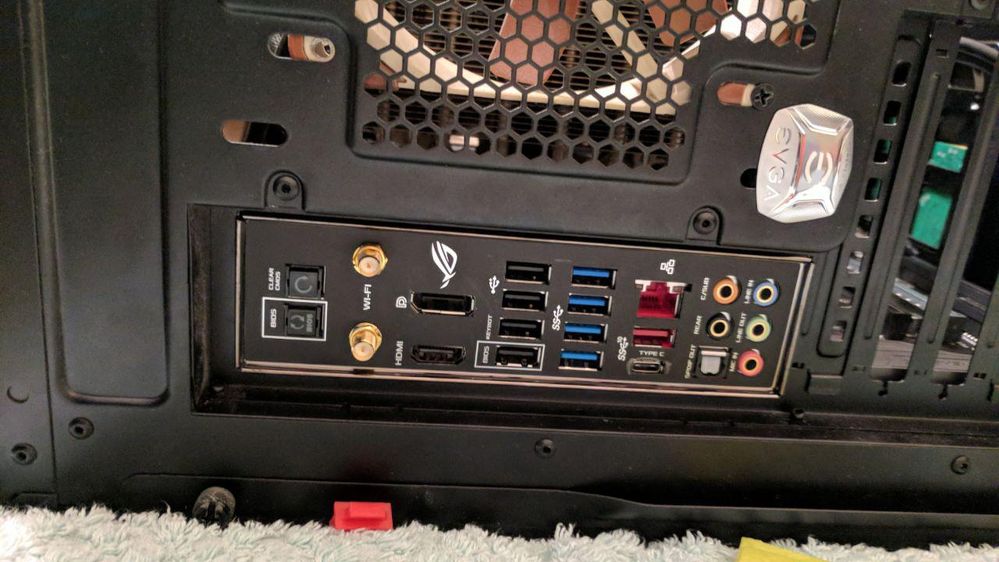

Hi there ppl,

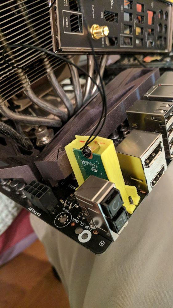

I've managed to install an Intel 8265 AC wireless and Bluetooth 4.2 combo. Everything works like a charm, even from Bios. I've 3D-printed a little mount for the card, and with some patience the results are very good. Here are some pictures:
68349
68350
68351
68352
68353
There's no problem at all, so if anyone wants to give it a try, just don't waste your time looking for the WifiGo module. This is great.

Well, Bro, this is a very DIY project and, more important, it's a way of fixing the lack of the official metal module. It's not an official guide of anything, and I've just only exposed one solution I tried and got working. Needless to say, If you have a way to find and buy the official module, good for you. But in several countries, this module is not even avaliable, or you have to order it, used, from china or taiwan. So it isn't as easy as you are saying it is.
I'm sorry if you had a hard time with your setup, and I understand your concern but stumbling on a thread from Google won't guarantee you that it's a 0-problem solution.
Being this said, It's been more than a year since I did my "mod" and it is still working like a charm. It only cost me almost next to nothing to print the adapter plus the wireless card, and an afternoon of relaxed tinkering and work. I'd call that a success.
Anyway, excuse my english and have a nice day

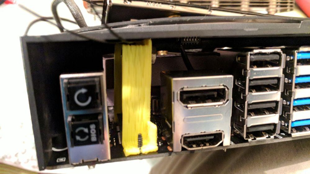

Hi there!
After few months and 3 attempt to create wi-fi holder my friend and I finally make it! (I miss a little with one leg, but it's not matter) A.Catalin, thanks for photos, they decreased number of attempt.
It's important (if you want to use my holder) that it is made of Polyamide (or Versatile Plastic, this is the same) because this material provides sufficient accuracy.
STP file you may download from here: https://www.dropbox.com/s/29hs681u79unbvn/holder.zip?dl=0
English is not my native language, so I'm sorry if I make some mistakes.

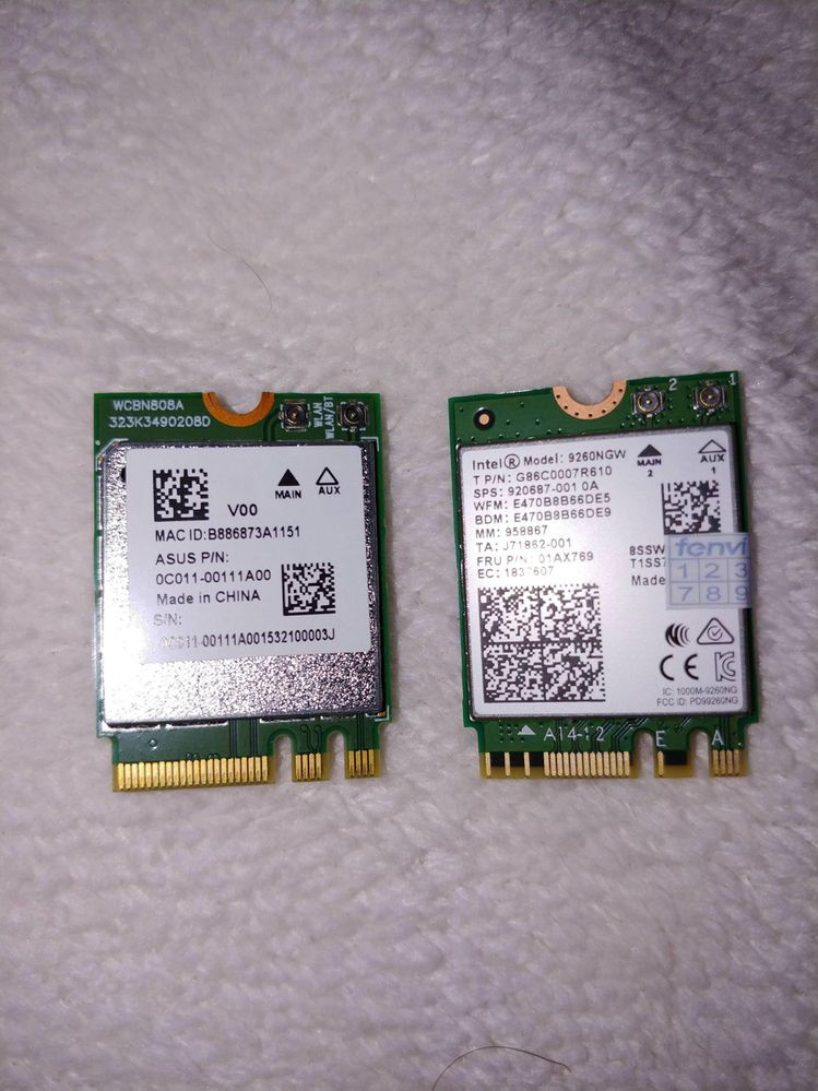

hi all sorry to resurrect an old thread but could you tell me for sure what wifi cards work on the ix hero i bought the 7265NGW from doing a quick google search i thought this would have worked but it didnt work
nothing was detected in windows and tried installing loads of different drivers but nothing worked so did another google search and found this thread from what i understand these to cards work is that correct thanks
9260 ngw
8265 NGW
i went for the 8265 works fine and the wireless works a lot better than my pci card
9260ngw installed today-works WI-FI and bluetooth. Who tried to install ax200ngw or ax210ngw?

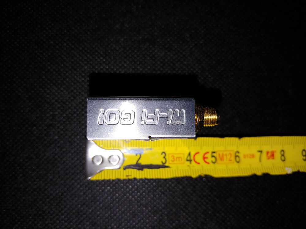

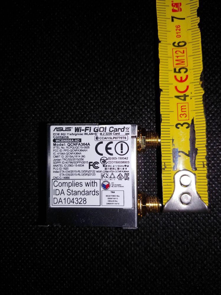

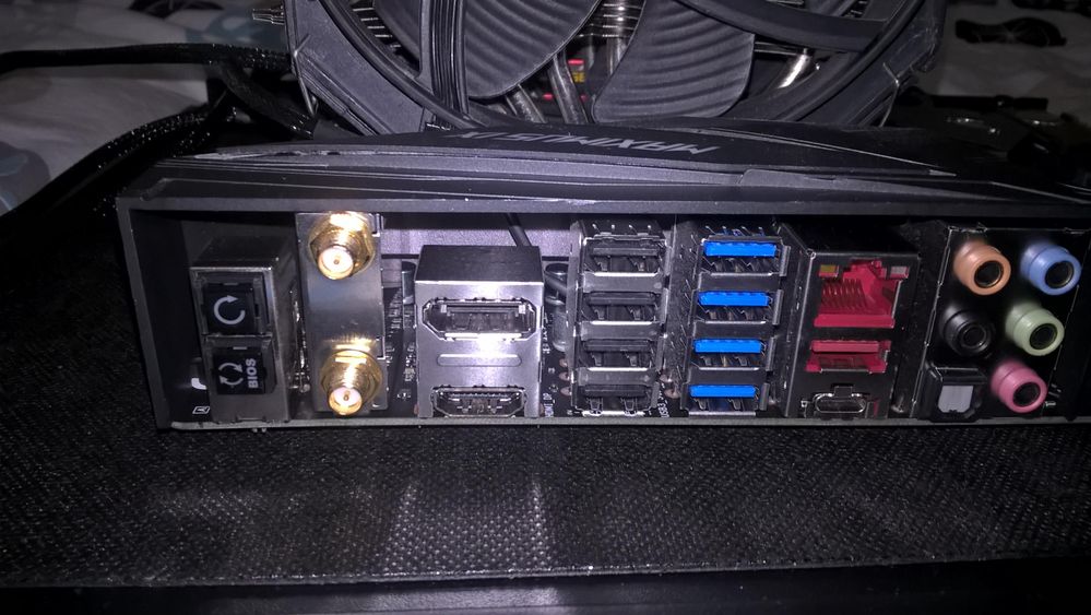

I just found a WI-FI go module for sale in my country for ~8€ 😉
It fits perfectly, killer 1535 inside. Now I have to find a 2T2R Asus antenna
701167011770118

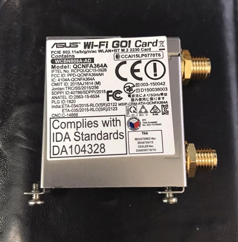

I found this: ASUS Wi-Fi +BT GoCard Mini PCIe M.2 WCBN808A-AD QCNFA364A Z170i Pro
It looks like the m.2 A key which I think can be plugged into an E key socket. Does anyone know for sure whether this would work in the Maximus IX Hero or not?

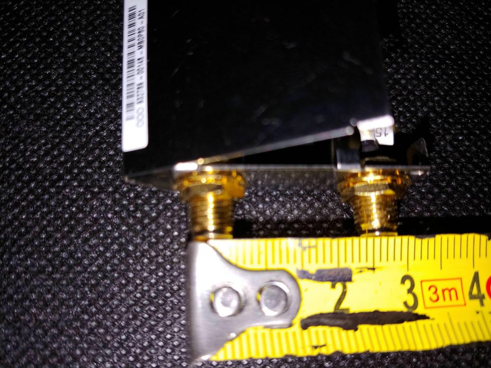

Sorry for the late reply, I just upgraded my module with an INTEL 9260, here are some measurements:
74699
74700747017470274703
