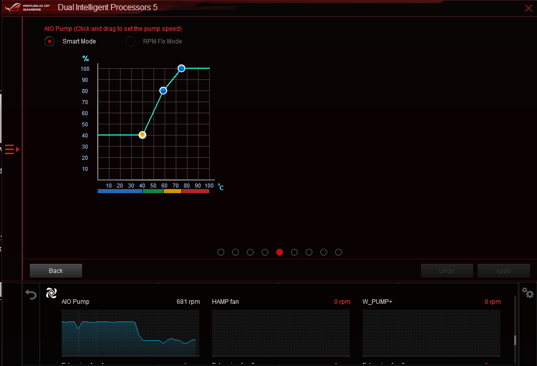

Got my new Motherboard/CPU/RAM today so started the upgrade.
Using an NZXT 820 I got back in 2012 still. 200mm front intake. 200mm top exhaust. 2x140 mm bottom intake, 2x120 exhaust (via the Corsair h110i v2).
I completed the following setup, and it is working fantastic:
Plugged the h110i pump power into the AIO header.
h110i fans on CPU and CPU-OPT fan headers (4pin)
front 200m on CHA1 (3pin)
2 x 140 bottom on CHA2 (3pin, via a fan splitter)
top 200m on CHA3 (3pin)
Am able to control the pump speed, and all fans as expected with fan xpert 4 in AI Suite (latest vesion on website as of this post). The only thing I am missing is getting the temp of the coolant in the h110i. I don't view this as a problem. This is a much better solution than the Corsair link software, because it's not generating a bunch of CPU load, and because fan xpert allows fan spin up and spin down times. This is a great additional feature so there's not constant fan noise from changing speeds as the CPU temp bounces around.
I went through the auto fan tuning setup and it did a pretty good job, but I did tweak it a little bit based on the temps I was seeing at ambient to have even lower fan speeds, but longer spin down times to provide extra cooling push when temps do creep up.

To test that it controls the pump speed, I had it on the default setup which is 100% pump all the time, and I updated the curve and hit apply, you can see the changes in the graph as it adjusts the pump speed:
The only thing is I can not see the liquid temp.
I can not control the LED on the h100i v2.
I don't care about either of these things, and I was able to keep my USB2 header for front panel connection which is nice. I didn't want to have to run a cable from the pump inside to an outside port either with a regular USB cable as some people have suggested. Fewer cables is better...
