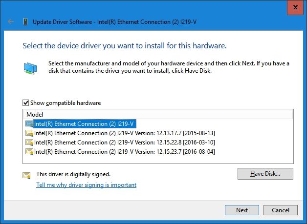

I have. Tried 20.7 from Asus, 21.0 from Intel, they mount and then are immediately shot and Windows restores version 15.
I even attempted a manual install from Windows, which is not recommended because of PROSet, but even so, on short notice Windows reverted to v12.
12.13.17.7
2015-08-13
Oh, also, I get this: Device PCI\VEN_8086&DEV_15B8&SUBSYS_86721043&REV_31\3&11583659&0&FE could not be migrated.
Last Device Instance Id: SWD\IP_TUNNEL_VBUS\6TO4_ADAPTER
Class Guid: {4D36E972-E325-11CE-BFC1-08002BE10318}
Location Path:
Migration Rank: 0xF000FFFFFFFFF112
Present: true
Status: 0xC0000719
and this:
Device PCI\VEN_8086&DEV_15B8&SUBSYS_86721043&REV_31\3&11583659&0&FE requires further installation.
Nobody seems to have an official answer about what "device not migrated" means, not do I know if the "6to4" has any bearing on the issue (likely not) nor do I know if it's just a notification the device requires further installation or if it's an error that triggered the revert.
New data:
60402
OK, what am I watching here? Why is this naming scheme different from Intel and Asus'? Am I on the latest driver, and is this a display error?
Windows claims my currently loaded driver is in Windows\System32\drivers\e1d65x64.sys. File is signed by Intel and Microsoft, and is listed as:
12.13.17.7 Modified 2016-04-20, Signed by Intel on 2015-08-13 and by Microsoft on April 2016 AND Aug 2015.

I was so fed up of this behavior that I upgraded to ASUS Z270 Maximux IX Hero. Stock Bios 0503 did not make Windows 10 to force install this old driver. But After updating to it's latest BIOS 0701, Windows is again shoving 12.13.17.7 down the updates even though I have 12.15.23.8 as latest version installed.
IMNdi wrote:
OK, what am I watching here?.......
Only two things work to make the new driver stick. Use either one of the methods.
  • Let Windows install the wrong old driver 12.13.17.7. Install 12.15.23.8 manually using update driver wizard. Then run Windows update and Windows will again override it with 12.13.17.7. Now from driver tab of device manager, click on Roll Back Driver and select the first or second option as reason of roll back.
  • Let Windows install the wrong old driver 12.13.17.7. Download and run RAPR from here. Make sure you run it as admin mode. Click on Enumerate and select the faulty driver and FORCE DELETE. Then download WUMT x64 or x86 from here. Run it as admin and search for updates. Now it will show you that Intel driver is available for update. Select it and click on H (Hide button)
