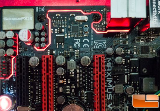

I use logitech G430 headset. SupremeFX e depends. continuous electrical sound comes from the right headphone. When you install the motherboard rear output, the sound disappears. I did the driver update, but did not change. My previous motherboard via the formula did not have this phenomenon. and there is a point I wondered. SupremeFX not cause the LEDs as well. maximus formula there was also this LED lights.56851

Both Rear and Front outputs are driven by SupremeFX features.
This good news is no need to pre-outs. the problem is solved. Thank you
