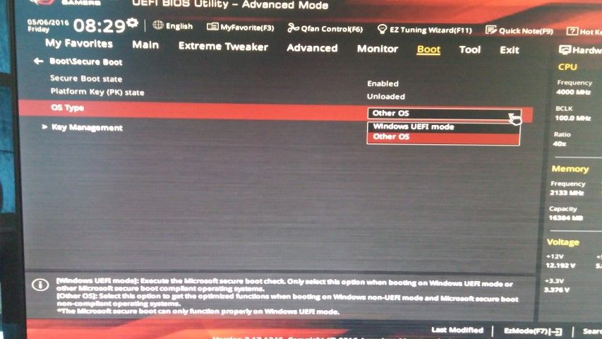

###Boot Compatability Support
57281
###Boot Secure Boot Options
57282

I chatted with Asus support and they insisted the SSD was defective (both SSD's). After further chatting, they suggested I disable SMART check in the BIOS... after disabling SMART check, no issues with starting/rebooting. I'll try another new SSD later, but for now, this does seem to solve the issue.
