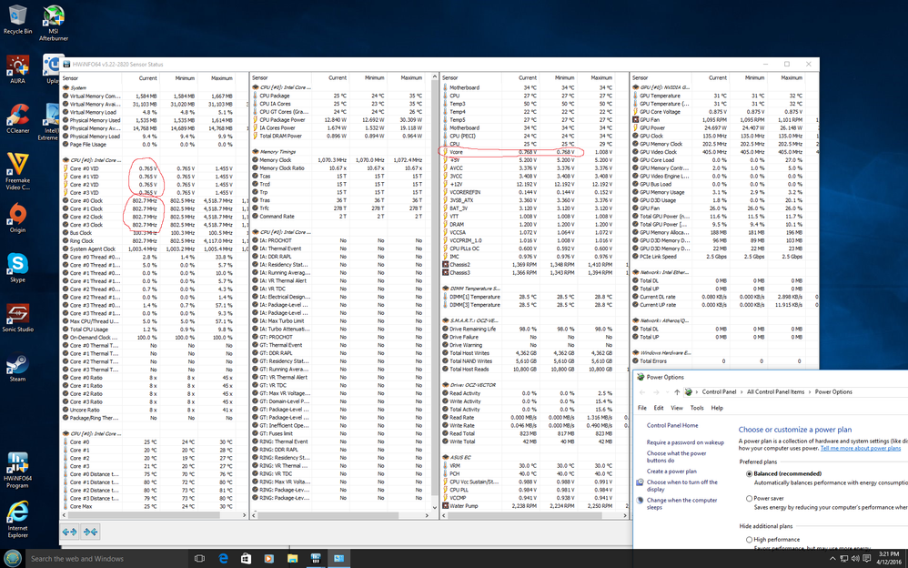

And the thing that i noticed that in adaptive mode my frecvency never goes down to 800 mhz, it stays at 4000 mhz and voltage at 1,160V. Why it does not go down to 800 mhz?
Nate152
Moderator
Make sure you have speedstep enabled and the c states enabled in the bios, your cpu should be throttling to 800MHz using adaptive mode.
