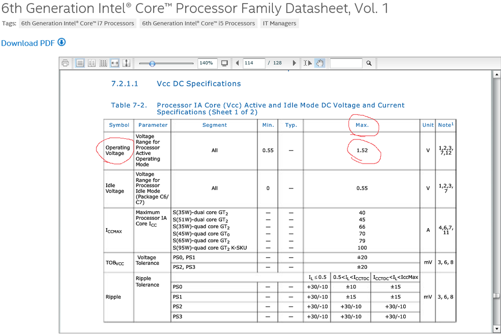

Hey Nate! I updated the bios from 1202 to 1701 and false q-code F4 bs and errors are gone..thanks. I do have a question in regards to the v-core. My cpu core voltage override is set at 1.31 volts running @ 4.8 gigs in manual mode. Temps on the cores don't go over 70 degrees with 65 being more average and no issues at all with realbench but I do see the output v-core reading up to 1.42 v during realbench tests on my rog cpuid. Now I've read that you shouldn't go over 1.45 but are they saying don't go over 1.45 in the bios where you input the data or the readings of the cpuid or hwmonitor during testing. 😉

1.42v for 4.8GHz sounds more like it and that's still very good, mine needs 1.52v for 4.8GHz.
Anything up to 1.52v is fine as long as you can keep temps under control which intel says 64c is the max safe temp, you can take stress testing temps to 90c but for everyday use and gaming no more than 64c.
You want to go by what cpu-z or HWmonitor is reading for actual voltage.
It might be better to lower LLC to 1 or 2 and set the cpu core voltage to around 1.38v and then see what it draws.
