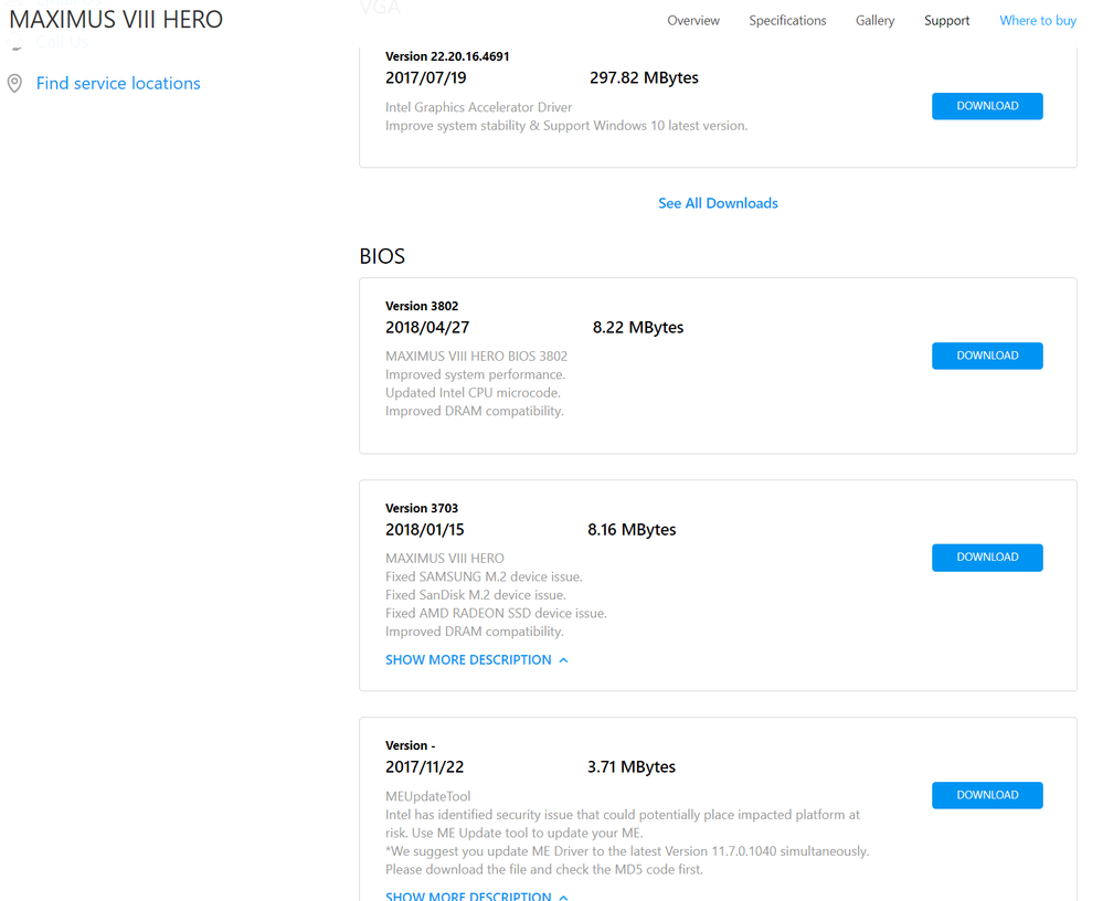

It looks like Asus has backed out their latest BIOS 3802 and now recommends 3801. I want to go to 3801 to see f this clears up my boot, shutdown issues.

ASUS hasn't backed out of version 3802. 3802 is alive and working fine for the Maximus VIII Hero. There is no official 3801 for the Maximus VIII Hero (the board you list in your other post). 3801 is for the Maximus VIIII Hero Alpha.

You're right, I was looking at Hero Alpha, my mistake.
The 3802 is not working fine for me and at least one other person I saw a post from with same symptoms documented above.
