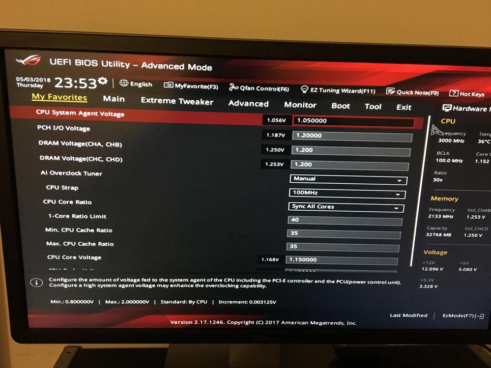

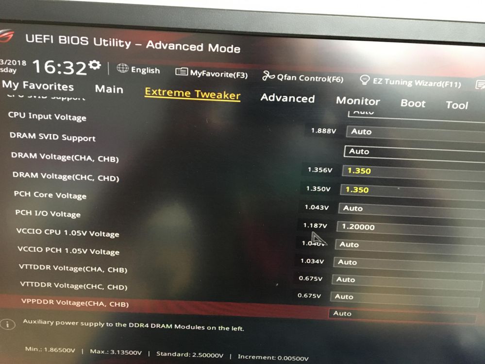

rzbierski
hello,
73630
I set PCH I/O Voltage - to min 1.200 (sys doesn't allow me to set lower)
I set DRAM Voltrage - 1.350
Works with 32GB, but with 64GB event doesn't allow to go to BIOS
Is something else what I can set to allow 64GB works ??
Thanks

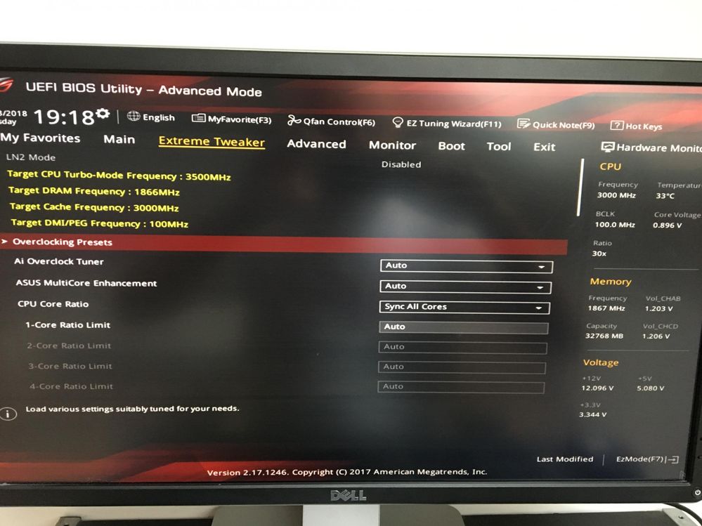

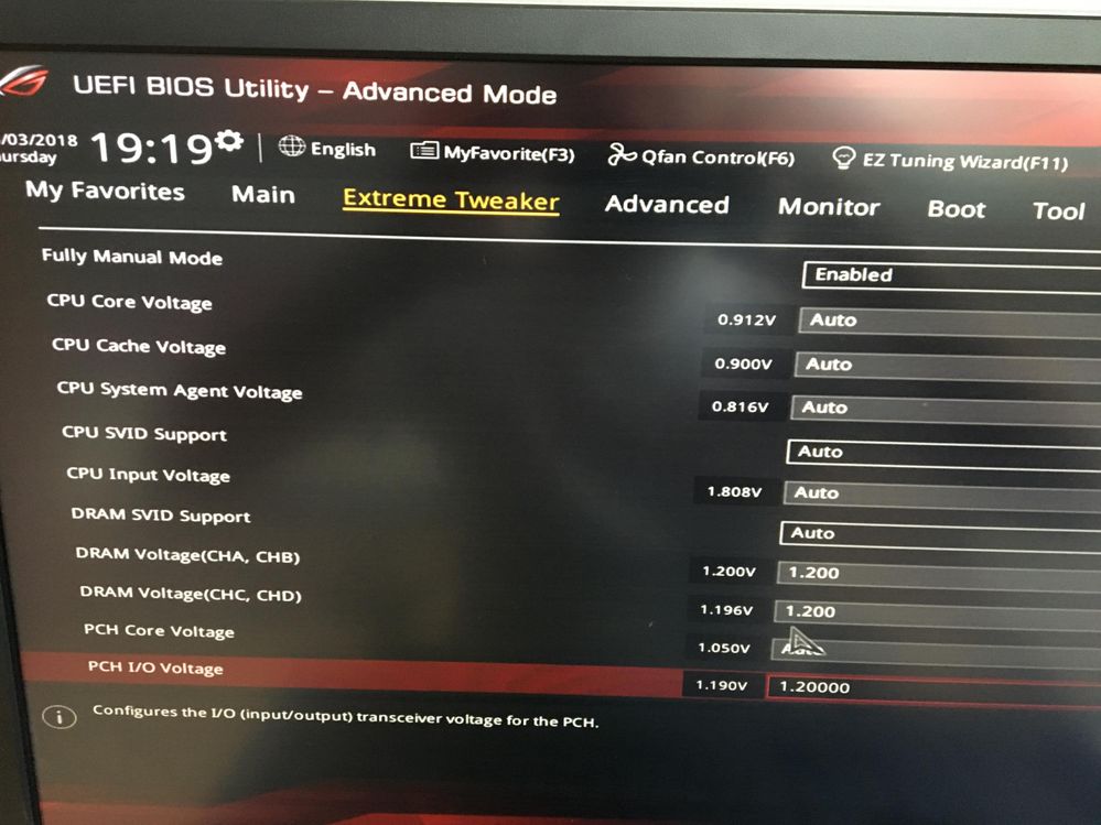

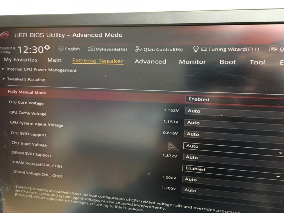

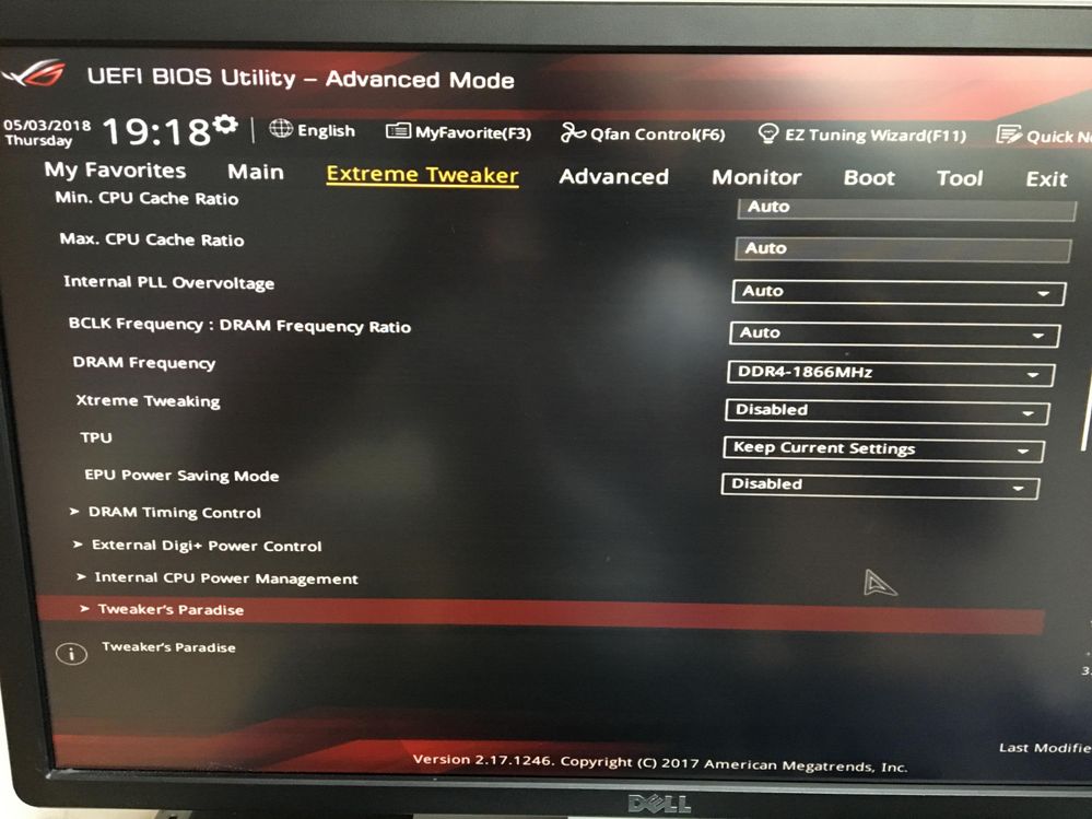

rzbierski
hello,
I have intel i7 5960 + Rampage V extreme + 64GB (model on first page) + 2x256GB SSD + GeForce GT 720
all settings in BIOS (I don't know why BIOS decresed speed of memory to 1866MHz - should be 2666Mhz)

Increase the CPU System Agent Voltage from 0.816V to 0.9 to start with and the go up in .010 lots until you have stability.

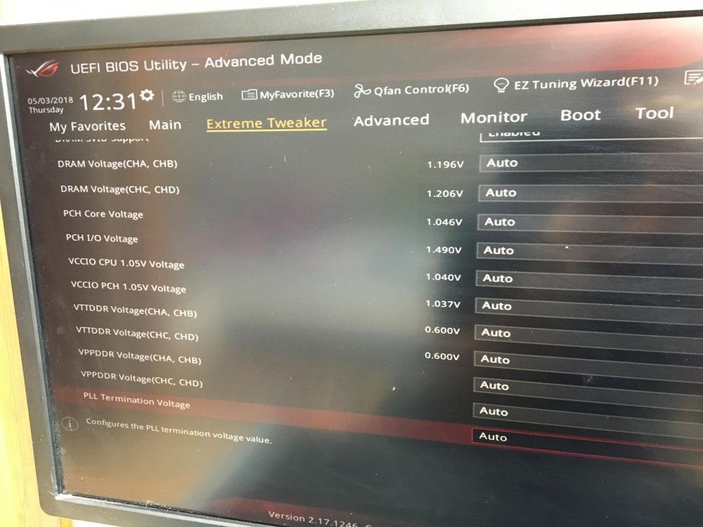

rzbierski
hello,
i have this cooling
https://www.corsair.com/eu/en/Categories/Products/Liquid-Cooling/Dual-Radiator-Liquid-Coolers/Hydro-...
I will check Your settings
OK, I set as below but it's the same 😞
With 5 DIMM is OK - 40GB, 2666 MHZ speed
When I add six DIMM i have bd code, i have to run in safe boot ( i have overclocking failed info) and BIOS see only 32GB with wrong speed (as below - 6x8GB is installed on MB, but only 32GB is shown) - hands fall 😞

You need to adjust your CPU System Agent Voltage. This is what the BD error you keep getting is related to.
