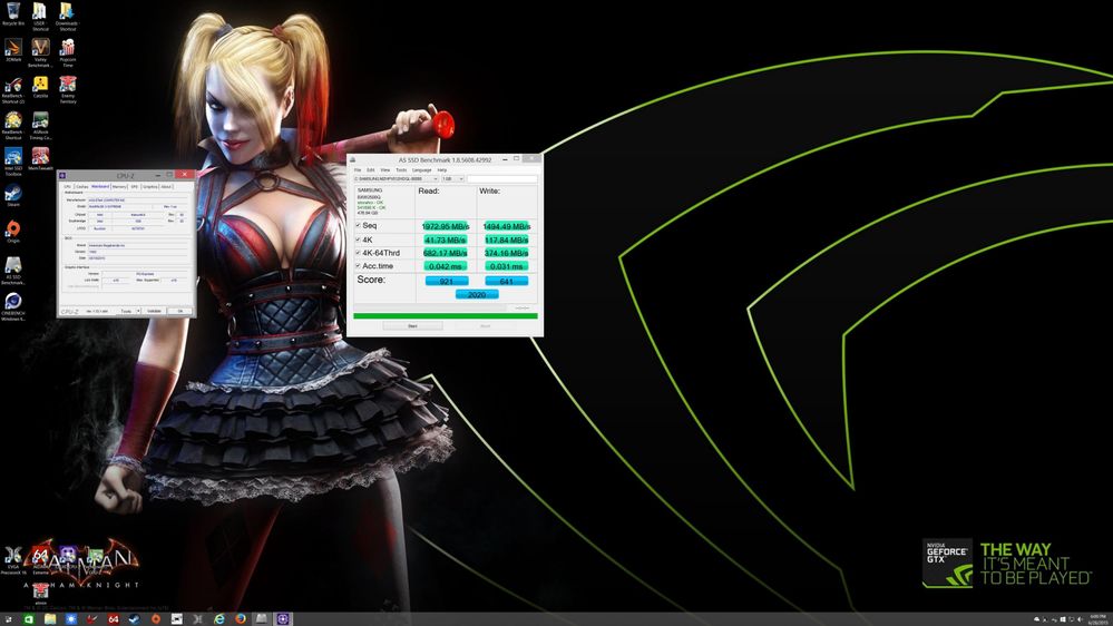

vmanuelgm,
I have the 512 GB version so it has a little higher specs, unless you optimize your system it is not going to obtain the advertized specs, especially after you have all tour programs installed and it's been used for awhile.
50178
There are many guides on optimizing your OS for better SSD response and longer life span
now another user has posted he has the identical issue. Specs are far from the same so the common factor is bios 1502.
https://rog.asus.com/forum/showthread.php?70786-code-79-then-Error-sending-end-of-post-message-to-me...
Menthol wrote:
There is nothing wrong with this bios, it works like a charm. If your having issues it's probably something else, if you want bios issues try another brand of mainboard to see the support you get.
vmanuelgm,
50178
Cant agree, my friend.
Since the very first try, just installed without a thing in it, the m.2 slot is slower than via pciexpress arise card...
You can try it for yourself, using hyperkit or another one...
http://nl.hardware.info/reviews/6075/8/samsung-sm951-256gb-pci-express-ssd-review-serial-ata-uitgezw...
The test in done with sm951 256 in pciexpress slot 16x... You can read it in "test"...
