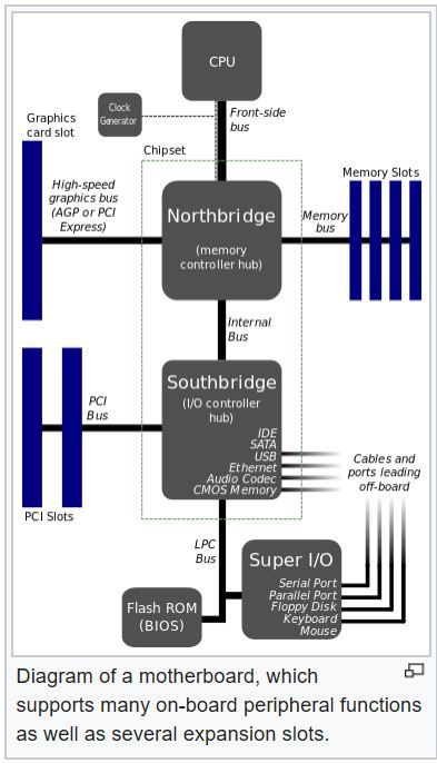

The AMI BIOS code 99 means "Super IO Initialization", which was a controller on older motherboards for various ports (USB, etc). Maybe the CPU has taken over some of its functions these days, I am not sure. The fact that you are getting the same problem with a different motherboard and various GPUs does implicate the CPU.
