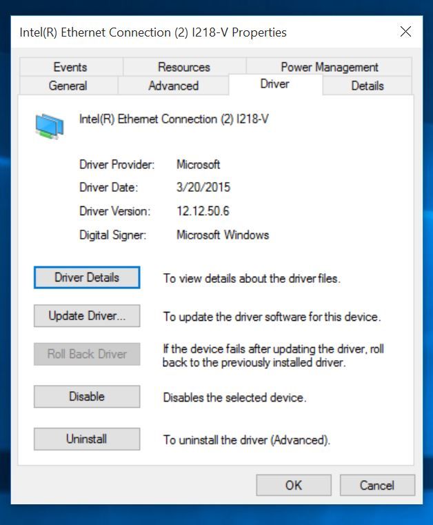

The default driver that comes with Windows 10 is 12.12.50.6

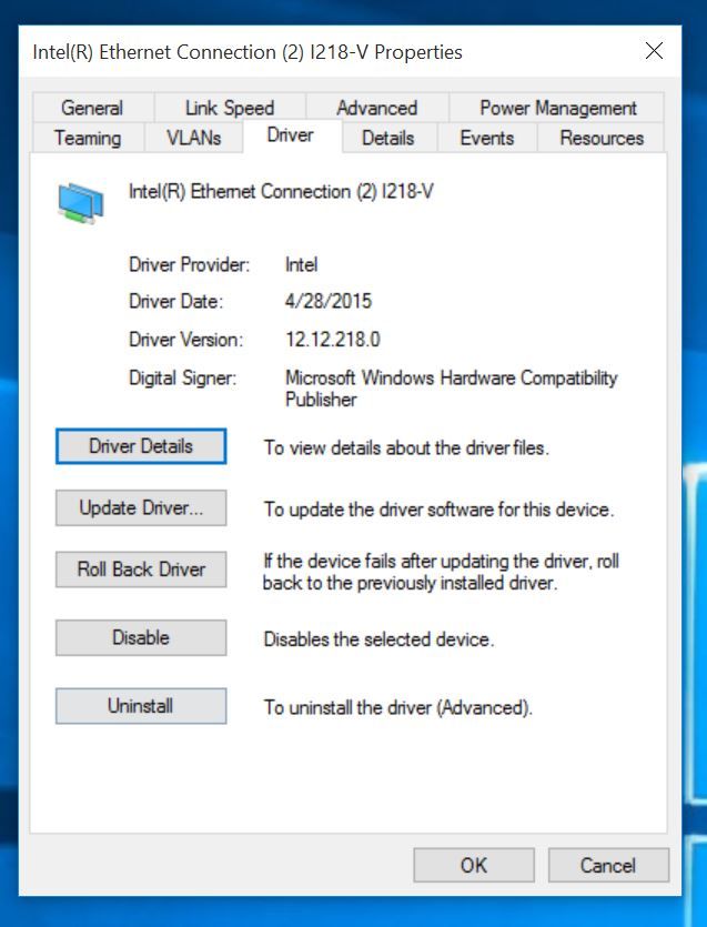

The latest one from the Support Page is 12.12.218.0

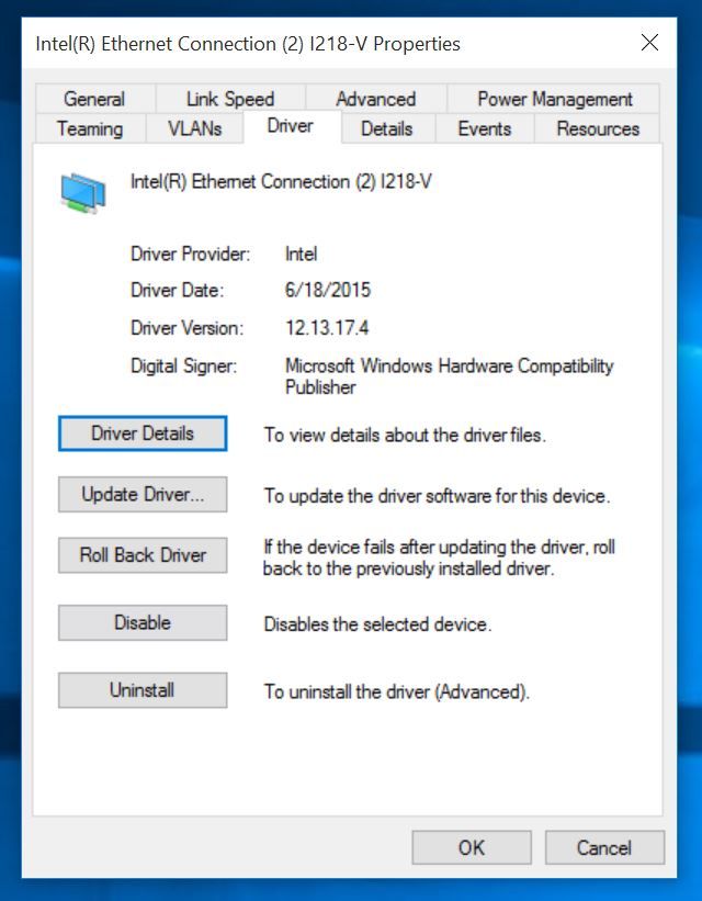

And the latest from Intel is 12.13.17.4

Try the following to see if it fixes your issue.
1. Uninstall the driver.
2. Disable the LAN adapter in the BIOS.
3. Reboot to safe mode and remove all traces of the driver with Driver Sweeper.
4. Re-enable the LAN adapter.
5. Install the driver you downloaded.
