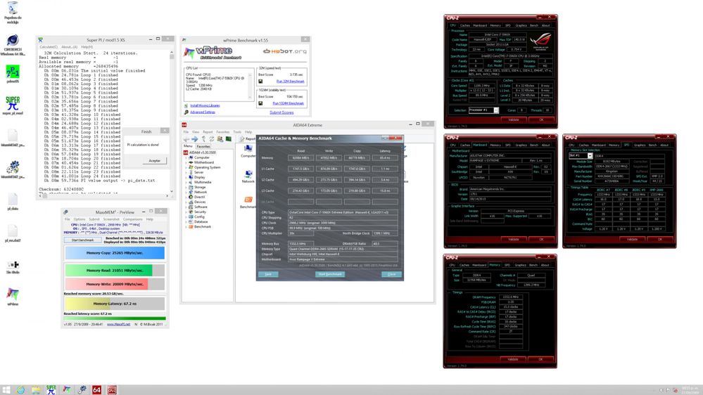

Anyway, here are few benchmarks with the FURY DDR4-2666 32GB kit. I'll drop some HCI Memtest or Google Stress App runs later on when I get the chance.
53585
