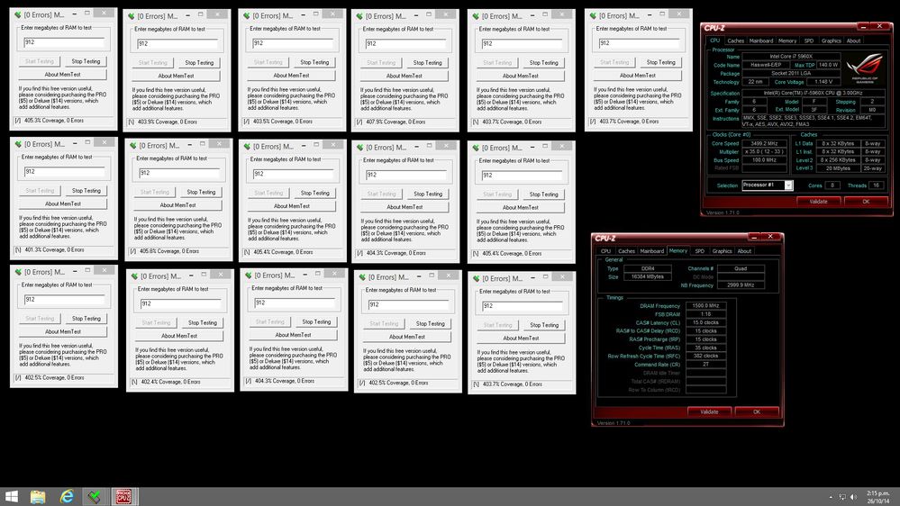

HCI MemTest is one of the best programs to find immediate and long term memory errors if any are present. Since it’s a single threaded program, it’s recommended to run as many instances of MemTest as you have CPU threads to increase the program’s effectiveness.
On my i7-5960X, I’m running 16 instances to test my memory thoroughly. Since it’s time consuming to open each instance one by one, I’ve written a simple Batch file to open all of them with a single click. The only requirement is that the batch file must be in the same directory as the memtest.exe. For the other Haswell-E owners, you can edit the batch file in Notepad and erase the number of instances to match your CPU cores. Once you have your instances ready, open Task Manager. Look at the amount of unused memory available and divide it by the number of instances. The result will be the amount of memory you will type in the each MemTest window.
42857
Memtest is designed to run as long as you wish. But for an everyday system, four full passes (400% coverage) should be more than enough. But if memory stability is vital for your system, you can let it run overnight. If any errors show up, continue tuning the System Agent Voltage.

And to finalize this guide, here’s a screenshot of my i7-5960X finishing 4 full passes of MemTest. It’s not a good sample and needs a System Agent Voltage of 1.14V to run memory at 3000MHz. It’s been running for a few months now and there are no negative side effects of running at that voltage.
42859
