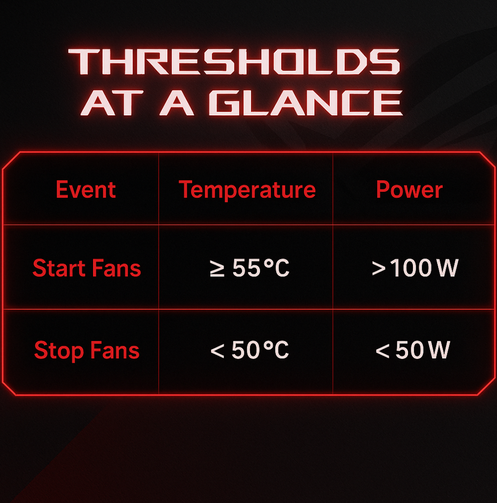

On ROG Astral GPUs, this behaviour is handled by 0dB mode. The fans stay off during light workloads and only start spinning when either the GPU temperature or power draw crosses a defined threshold. It’s a simple, effective way to reduce noise without compromising cooling when it matters.

Even without active 3D workloads, running high-resolution, high-refresh displays (like 4K 144Hz or 240Hz+ panels) can prevent 0dB mode from engaging. This is because maintaining smooth output at high refresh rates increases idle power draw, often pushing it above the 100W threshold even at the desktop. If you're using multiple monitors or high-refresh displays, expect the fans to spin intermittently or remain active, even when GPU temps are well below thermal limits.

RTX 4090/4080/4070Ti/4070/5000 Series (>50°C for 5090 Astral LC)

The 0dB mode is governed by both GPU temperature and power draw. When creating a custom fan curve, you can define the fan start-up point. However, to retain 0dB functionality, the fan curve’s starting temperature must be set equal to or below the default 0dB threshold (typically 50–55°C, depending on the GPU model).
If the custom fan curve is configured to start spinning the fans at a lower temperature, 0dB mode will be bypassed, causing the fans to run even when unnecessary.
