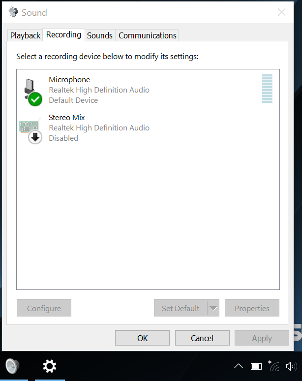

Does anyone know how to fix this? I've tried uninstalling/reinstalling the latest Realtek HD drivers and uninstalling/updating sonic studio, but haven't had any changes.
EDIT: It appears that the webcam is using the headphone jack and thus overwriting whatever is plugged into it, as the headphone jack can sometimes work but if the webcam is ever activated it will immediately overwrite it.
It's like the Realtek High Definition Audio is being used by both the webcam and the audio jack, and the webcam is taking priority but there is no way to choose to recognise the audio jack.

I'm assuming the headphone jack supports dual channel sound, but when I plug in my headset into the port it doesn't detect my microphone, only displaying the built-in mic as the only thing read.
If the port is fine, does anyone know how to fix this? I've tried uninstalling/reinstalling the latest Realtek HD drivers, but haven't had any changes.
The GX501 supports 4-pole 3.5mm connectors for headsets with mic. For the playback devices, the default device icon does not change when you switch from internal to external when using that connector. We have tested again and it's working fine.
Have you tried testing the mic, or is it just the icon is confusing?
