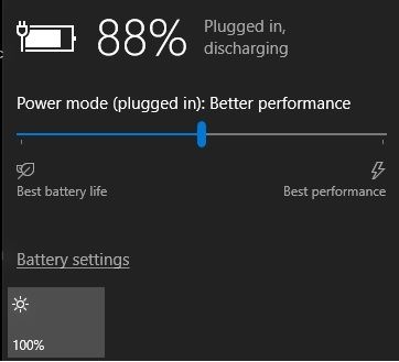

AIDA64 is showing a charge rate jumping around 5,000mW when the game is full screen, 15,000mW when minimized, and 20,000mW when the game isn't running.
I did capture the below screenshot with a bit of quick alt tabbing.
74840
I'll allow the batter to discharge down to about 50% and do a bit more testing later.
Edit: The only difference that made was the charge rate increased to 37,684mW when the game wasn't running, still battery is draining while running.
74843

Please RMA to have the laptop checked out. It shouldn't be discharging at 44%.

Yeah totally agree with MasterC and thanks for providing the screenshots as the "discharging" seems to be the key here.
