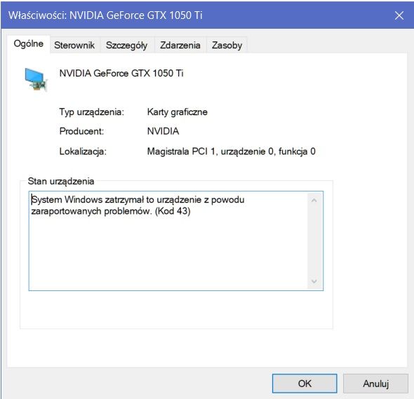

Second, from then until now in Hardware Manager my 1050Ti is disabled with code 43.

Sometimes GeForce is active, but everytime I will use it (game, program) there will be always BSOD with VIDEO_TDR_FAILURE. After reset card is inactive with 43 error.
This was happened when I changed fast start to disabled in UEFI, or used laptop on battery. BSOD is showing whenever laptop is plug in into power source, or run on battery.
I'm starting to thinking, maybe GeForce is faulty. Chip or Video Memory. But in service they tested and says that the hardware is ok.
