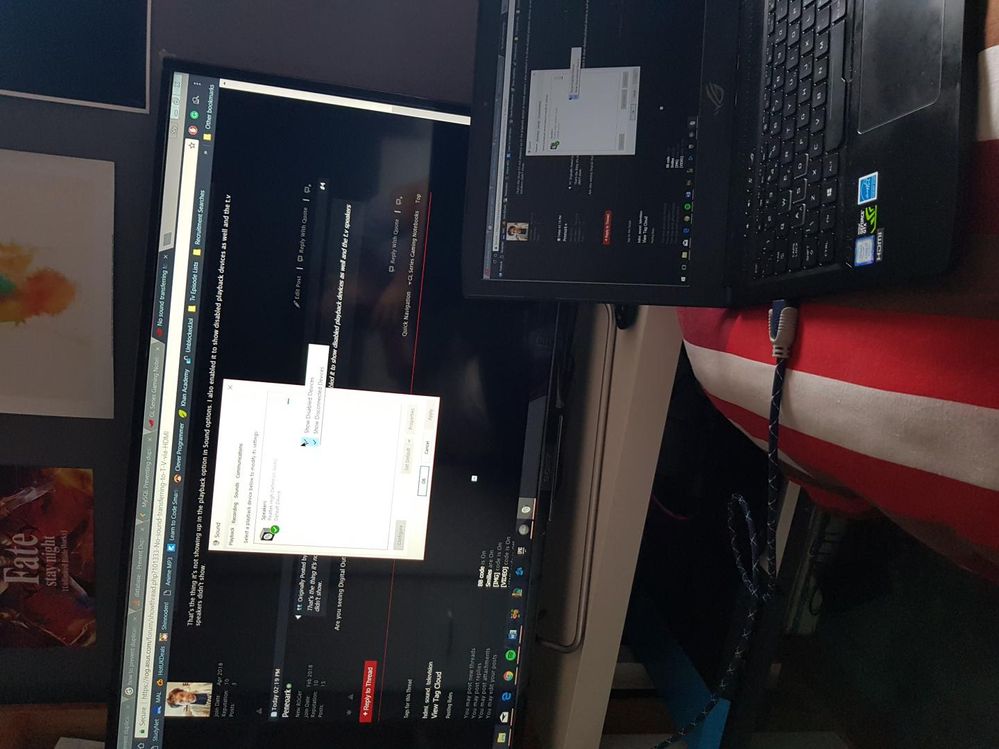

That's the thing it's not showing up in the playback option in Sound options. I also enabled it to show disabled playback devices as well and the t.v speakers didn't show.
Are you seeing Digital Output as an available sound device? If so, try selecting that.
72862
Nope

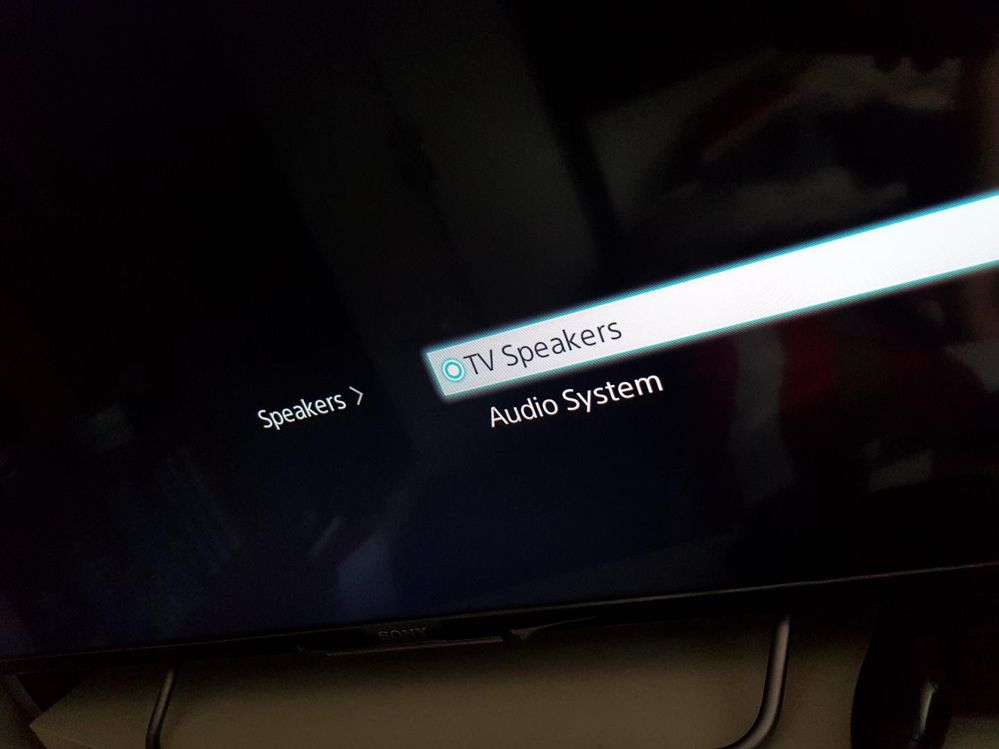

Can you test it on another TV, or possibly test with another HDMI cable? Also, can you check your TV settings and make sure that the audio is set to HDMI? You can also try defaulting the TV settings.
This is really strange.
Still no change, tried another tv and tried another HDMI
72864
I'm at a loss here and nothing more I can test without getting my hands on it. Hopefully you will find a solution. Good luck.
