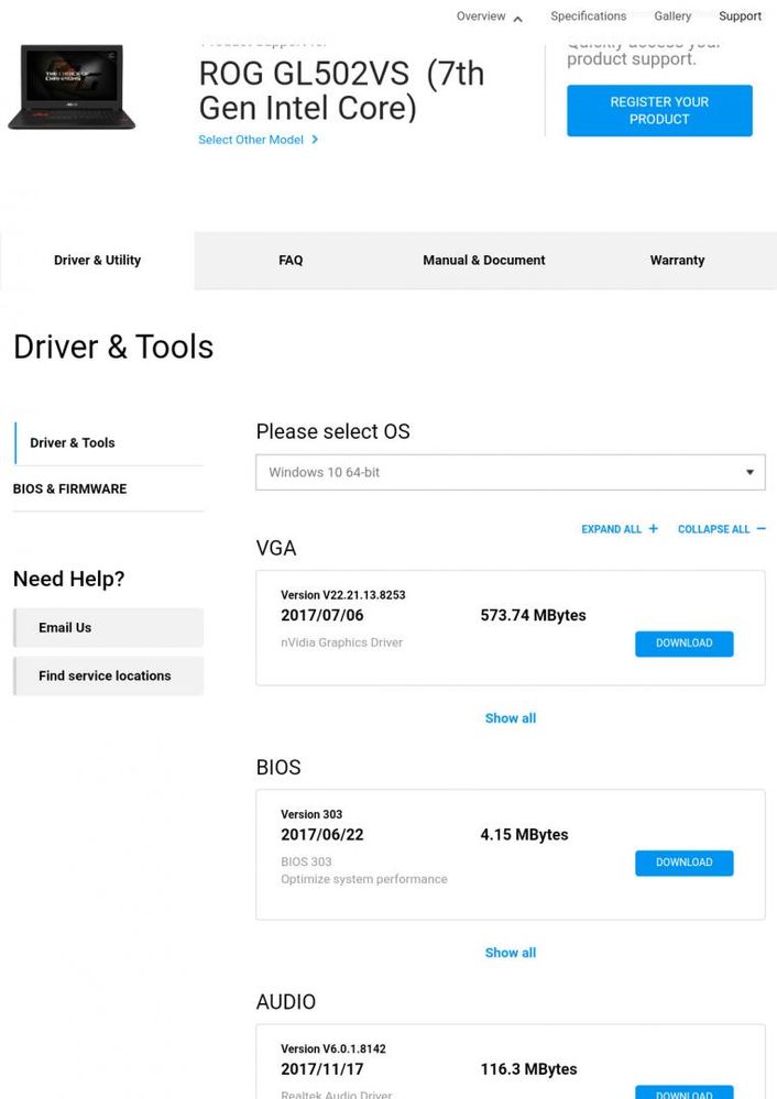

I have already updated the bios to the latest one available (303). The fans are at max. I don't want to undervolt too much since even now i am getting power limit throttling, though that doesn't decrease performance as much as thermal throttling.
I want to know if there is faulty hardware issues with my lap, if so then i need to send it to the service centre. The issue wasn't present when i initially started using it.71468

I have another doubt. After i initially thought it was a driver issue and installed the OEM driver i then never updated it (ASUS didn't release any new oem vga drivers). Should i reinstall geforce experience and update to the latest driver from nvidia? Geforce experience did not come preinstalled and i had downloaded and installed it to update the gpu drivers. After resetting the pc i didn't reinstall it so that the driver wouldn't update. So now should i update to nvidia's official drivers or stick to the oem driver?
NVidia drivers, apart from drivers like chipset and sound ones, are universal. You should always install the latest from NVidia web-site (or let it update itself), it will work according to your hardware.
TL : DR update, don't use Nvidia OEM.
