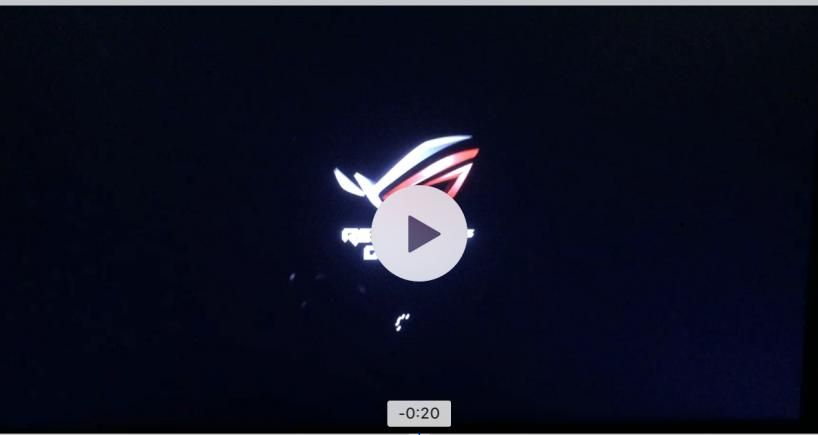

This issue is really annoying because I went to service as was recommended by ASUS support and they haven't fixed it. As result during test in service it works fine, they accepted it for repair and they only updated BIOS and say that everything is fixed and if you have any complaints then reproduce problem with engineer and then we will maybe accept it again for repair. Showing video with reproduction of problem is not enough for them.

My ASUS ROG Zephyrus M GM501GS has had this fault from day 1.
I've tried numerous things, without success.

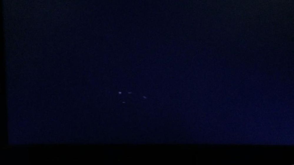

Few hours ago and after 3 weeks of regular use, my GL702VS Got blocked while trying to start PUBG test server, however after 15 mins or so I had to force shutdown, after that the screen never turned on again regardless the OS seems working as I can see shadows on the screen, like when you turn off the screen. At startup does not show the Asus logo nor anything and I can only see this shadows at a certain angle thanks to the environmental light I my room. I have tried everything from trying to guess the windows opened to uninstall the graphics drivers, to log into the Bios. drained the battery out to start over but nothing seems to work to make the screen turn on.
