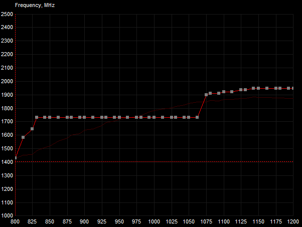

  • Run MSI Afterburner, click on profile 1 (out of 5). Then press Ctrl+F. (1 - least heat, but may be unstable for some... 2, bit more voltage etc till 5.)
  • You will see my Voltage Curve (screenshot). What you'll see that it's flat until 1050mv. that means. 1050 will never be used, so will never be used any voltage except 831mV @ 1860 MHz and below.
  • Click apply to test this curve
  • If this curve is not stable for you - edit it to your taste: Click on 831mV dot and move it lower, so that lower freq will be used for that voltage, and for 1860 freq next available voltage will be used. Etc. Work with leftmost voltage dots to make everything stable.
This curve drops heat of GPU by at least 30%, which is huge.

I manually tweaked the graph that it went to after I hit apply & this one seems to be working. Getting a steady 75ish when running Arkham Knight maxed out (down from 85+).
62014
Not sure why the one on page 1 doesn't work properly... different firmware version?

OK, hopefully attached my profile.
Profile 1 - original one uploaded at the start of the thread
Profile 2 - the one that I originally used in Arkham, but has been unstable (Xcom 2 kept crashing)
Profile 3 - the one I'm currently using & seems pretty stable
I suspect that limiting the GPU frequency to ~1500MHz will impact performance, but for me the heat (& fan noise) reduction is more than worth it.
Hope that helps 🙂

What exact MSI Afterburner version you're using? I also noticed such interpolation, but only at the edges of the graph. Did my best to make it flat, but looks like something has changed.
I'm using 4.3.0.9269

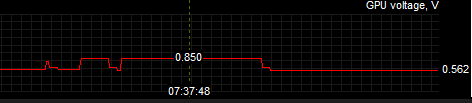

Just to be clear, you're seeing your voltage max out at 850mV?
Temperatures in the mid 80s won't do your system any harm, but it's odd that limiting voltage makes no difference.

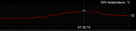

Just to show what it should look like:
Voltage should flatline at 850mV (or wherever your flat section starts on your profile):
62095
During gaming this reduces my running temperature by approx. 10 degrees compared to when the voltage is running at 1000mV+:
62095
