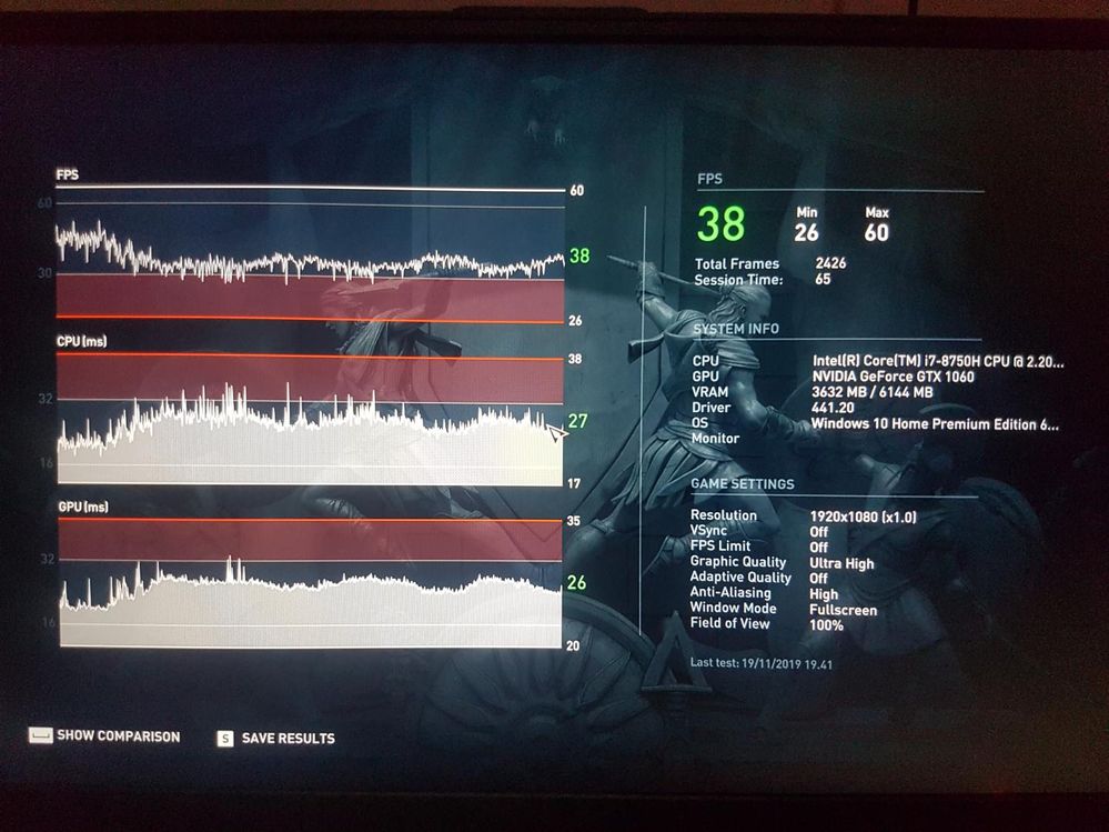

my laptop often get FPS spike lately, Getting heavy, stuttering worse and worse..
I didn't realize at first since i'm playing an online games, because I thought that it was come from my connection.
but when i play an offline game last night i realize that it was not, it's my device that have the problem.
i'm always use trusted resource for update, like windows update, Microsoft Store, GeForce Experience, MyAsus, Intel Driver Support and Assistant.
I have tried many ways, such as removing Intel and NVidia graphics drivers using DDU, and reinstalling the latest version of the driver, disabling Game Mode and Game Bar, disabling Full Screen Optimization, Changing Battery Settings, Changing Nvidia settings, removing NVidia Experience, scanning for viruses, but that doesn't help much.
I don't know which update that ruined my device, I really love my laptop and I'm very desperate here.. 😞
images for comparison:
taken at November 16th
83032
taken at June 1
83033
and no, it was not temperature problem since the one at June 1 have more heat since i'm gamming comparing at Nov 16 that taken just for test
and Fan always at Overboost Mode

fixed by Mr.Dali from Asus Support.
for everyone that already feeling hopeless from the uselessness template answer from NVidia or Windows Support that only give answer like rollback windows update and/or factory reset, here I share what asus support tell me to do.
in short.. Change Minimum and Maximum Processor State, under Processor Power Management in Battery Plan Setting.
- in Minimum Processor State, change ON battery to 5% and Plugged in to 95%
- in Maximum Processor State, change Both On Battery and Plugged in to 99%
(in my case both Min and Max Plugged in was 100%, I think that was default because I never change it before)
the result of my test after change the processor state:
83065
we can see the CPU performance still not stable as june 1st, and I still have loss around 2 FPS.
I don't know why and how it was able to messed up my laptop performance, but this can serve as temporary answer, till windows fix their damned update..
it works for me and I hope it can be works for you to that have a same problem too.
