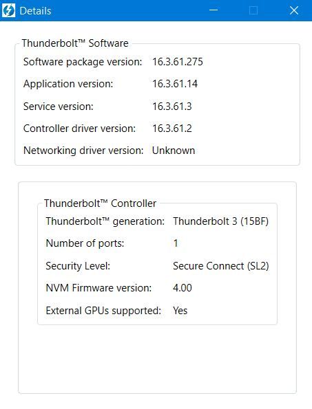

I bought a GL502VM (7th Gen CPU) a few months back, saw the advertising for Thunderbolt 3 support and was moved to purchase it. Recently I have been thinking about purchasing an eGPU dock to connect a GTX 1080TI, however while browsing through the ROG forums I came upon discussions that the GL502VM may not support full Thunderbolt 3 speeds at 40Gbps, some claimed that the chip only supported up to 20Gbps. Before I spend a large amount of money on the XG Station 2 I need confirmation of whether the GL502VM is capable of completely running at full bandwidth.

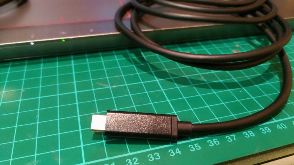

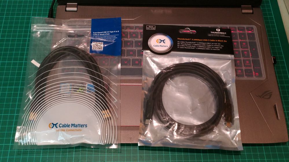

For XG Station 2 owners, the box comes with a really short Active Thunderbolt 3 cable, length approximately 30cm, meaning your XG Station will have to be placed side by side to your laptop.
To avoid the situation of heated winds blasting at me during my gaming sessions (unless it's winter then I don't have to turn on my heater), I have attempted to purchase longer cables. I have selected these for testing:
[Certified] Cable Matters Thunderbolt 3 (40Gbps) Cable in Black 6.6 ft / 2m (Thunderbolt 3 device co...
Cable Matters SuperSpeed USB 3.0 Type A to B Cable in Black 6 Feet
These cables will allow my XG Station 2 to be placed up to 2 meters from my laptop.
66597
66598

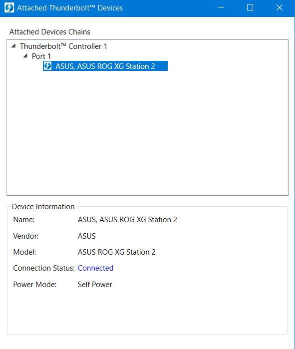

Tests and benchmarks:
Conclusion? It works like a charm!
XG Station 2 and GTX 1080TI were recognised instantly upon plugging the cables in.

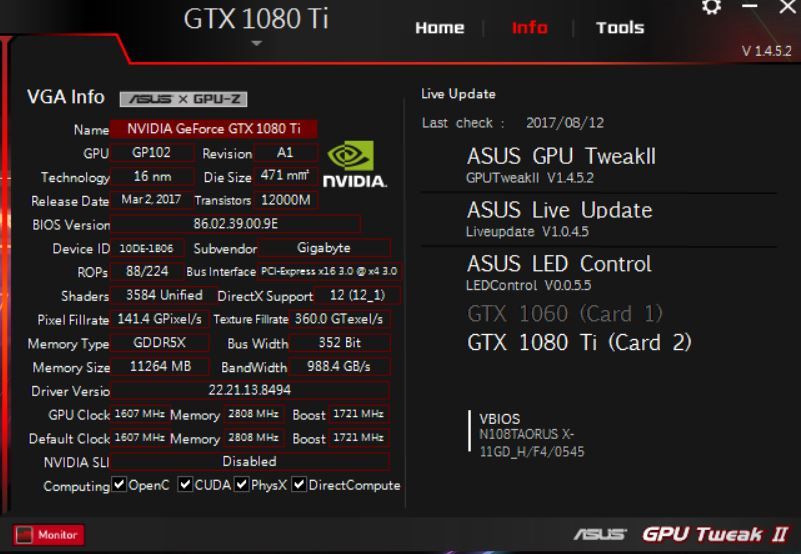

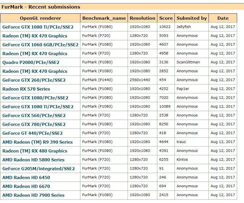

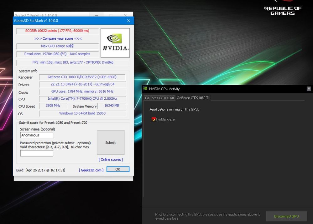

Furmark Test: (this program is able to detect the GTX 1080TI inside the eGPU, unlike 3DMark which doesn't)
66594
66595
Scores well above expectations 😮 Looks like the 2M Thunderbolt 3 cable is Active and supports up to 40Gbps transfers.
Have been doing a stress test for 12 hours as of now, and no disconnections have been observed, this is awesome news.

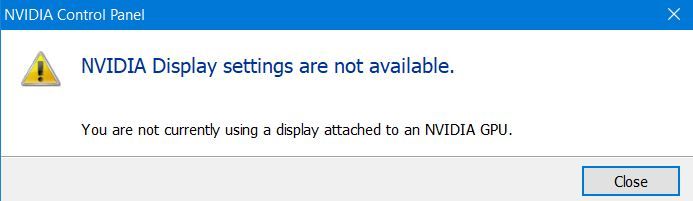

Remember when I mention if I disable the internal GPU (GTX 1060) and leave only the eGPU (GTX 1080TI) to output to my laptop monitor, I am unable to access Nvidia Control Panel.
66596
I peered at a forum that has done 3D Mark testing with the XG Station 2, and they mentioned that to get the full functionality of the eGPU, one must connect the GPU to an external display (not feed the visuals back to my laptop monitor like what I am currently doing). Might do a test for that in the future to confirm it.

I can do a 3DMark Firestrike in a short while (have to set it up on the laptop). What I can confirm right now is, with the internal graphics card (GTX1060) disabled and fully relying on the GTX1080TI to output the screen, I am not allowed to access the Nvidia Control Panel. The solution right now is activating both the internal graphics (GTX 1060) and the eGPU (GTX 1080TI) and manually select which programs will utilise which GPU. Also, G-sync does not work on the laptop screen when using an eGPU itself alone.

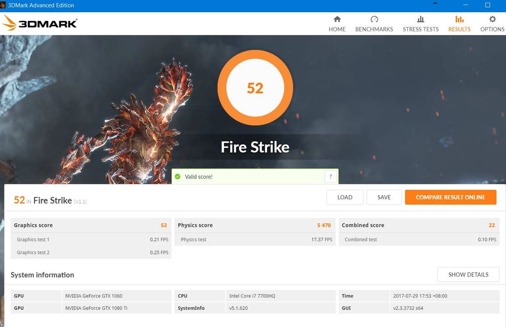

I laughed at the results, looks like I need to do more tweaking to get firestrike fully working with the eGPU.
