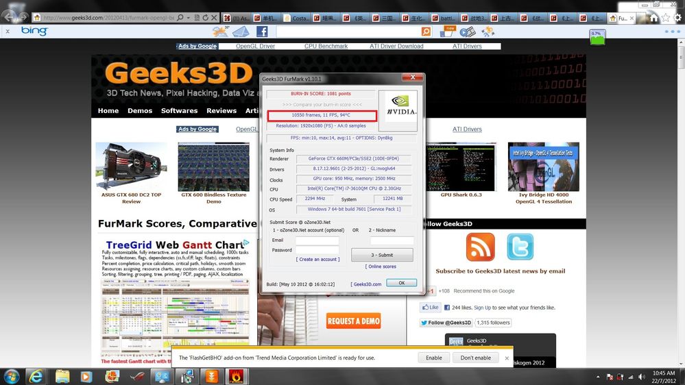

G55 furmark at 94 degree. 1980x1080 15 min test
lexlex
Hi everyone.
I bought g55 because of the advertised cooling
System. I'm upset with my temp test. I have read a lot that other g55 is at average of 80 degree.
I have tried reinstall the nvdia driver but same.
Anyone can help ? Thanks

I'm not sure about my room temp. But when idling , furmark read my gpu temp at 48 to 50. And once click on the 1980 , 15 min test, the temp jump immediately to about 68 degree at 2%.
If I return to warranty centre got to wait at least 5 days for them to check the notebook.
Normal surfing furmark reads my gpu at about 48 degree and I can feel slight warm at the keypad area. Normal ?
And is there any other software to recommend that can read CPU and gpu temp ?
I actually called up my country asus support and they say furmark is a 3rd party software and can't justify that my g55 have a heat issue.
I emailed customer service help desk and they advise me to reinstall gpu driver and update bios to 209.
Did the reinstall driver. Still same. Bios not yet. Is it advisable to update bios?
Anyway I don't think it's software problem as those g55 with the same driver and bios does not have this high temp.
