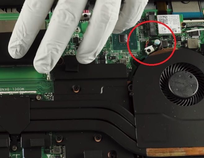

Zethriel wrote:
This quote led to the answer.
Ignore every other software,utility, driver and BIOS speculation.
The problem with the fan is the wire connecting it. It is either caused by the connector not connected properly or some interference from the chip that the wire hangs over.
I looked up a video how to teardown the laptop. The GL703GE is very easy to work on. The video is here:
https://www.youtube.com/watch?v=ix4eD2506oQ
From that video, you can see below that the wire in the video is looped around a resistor or capacitor or something (some silver cylinder). It does NOT hang over the chip near the fan. My machine, and most other pics I have seen online, show the wire handing over the chip that is just under the person's baby finger in the picture below.
I looped my wire the way it shows in the picture, made sure it was connected (it already was), and the problem has never happened since.
83340
