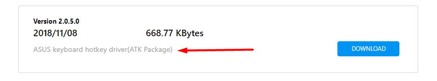

Have you tried manually downloading it from the Asus support page?
The support page redirect you to the store for this tool

you will also need the hotkey driver 83072
I'm having the exact problem as OP. So my Fn button didn't work and I tried to reinstall the ASUS Keyboard Hotkeys from the microsoft store and got the error.
I did try to install the ATK Package from the support website, but the problem still persist. Any help would be very much appreciated 🙂

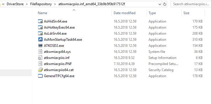

83427
you can try to start those files and right click on the .inf file and install .
AsHidService from services.msc needs to be running for the OSD to work. check that out.
Every thing worked after starting the ATKOSD2.exe
So I have created a schedule for it and now every thing is good
