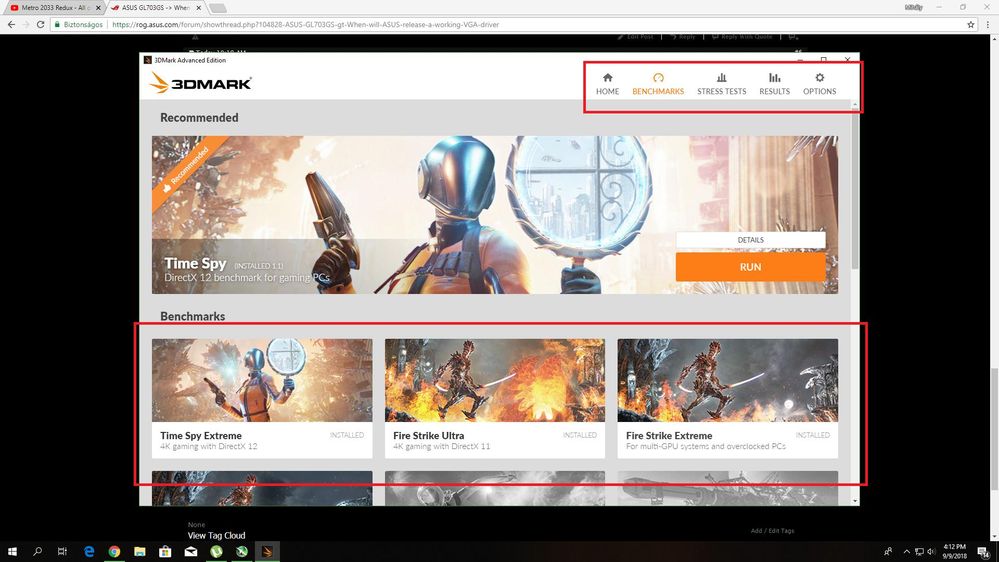

Could you please check check 3DMark? There is a free demo on Steam.
75653
When I swiwtch between the menus and when I switch back to the "Benchmarks" menu the pictures which I marked leave a faint black shadow after them while they are moving. On my GL703GS the ghosting/aftershadow is small in this case and may be hard to spot for the first time, but could you please check this?
On a perfect screen there should be no aftershadow/ghosting at all while those pictures are moving.
If you have time you can also run a Time Spy test, I can easely spot this ghosting/aftershadow during that test. Fire Strike also has it, but it is harder to spot, better to try Time Spy.
Thank you!

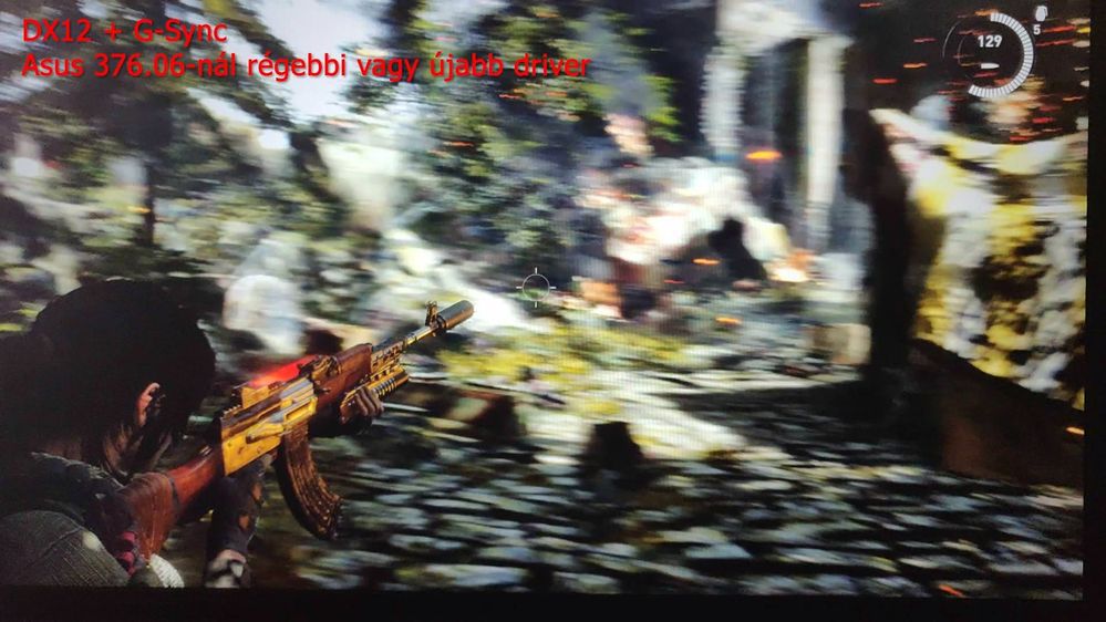

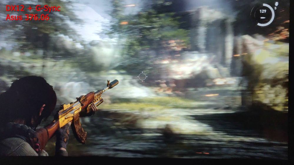

To help understand the problem more a comparison of Rise of the Tomb Raider:
This is how it should look like during fast movement:
75651
However this is how it looks during movement on my GL703GS:
75652
As you can see everything has a weird black aftershadow/ghosting.
All games are affected, I only use RoTTR because it is the most annoying in this one.
