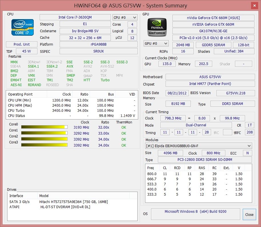

With rewben's helpful answers to my questions, I ordered the chip below that matched the stock memory's timings:
G.SKILL 16GB (2 x 8G) 204-Pin DDR3 SO-DIMM DDR3 1600 (PC3 12800) Laptop Memory Model F3-1600C11D-16G...
Incredibly, I ordered it Friday afternoon with free shipping (4-5 business days) to Virginia and it arrived Saturday! Dropped it in and it worked perfectly! All RAM running with timings 11-11-11 and the clock operating near 800 MHz (per HWiNFO64).
Configuration: 8G G.Skill + 4G Hynix (stock) + 8G G.Skill + 4G Hynix (stock) = 24G.

to verify that, you can check out the SPD (for each memory slot) in cpu-z, i think.
if possible, you should run memtest overnight to be sure the ram mix is fine.
memtest ran about 4 passses okay overnight. The voltage readings are from the speed page of cpu-z. I am just curious if the motherboard can actually set two voltages or cpu-z is just reading the default settings from the individual ram slots.
