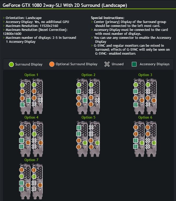

Hmm, not sure this is exactly it. I tried connecting a DisplayPort to Card #2 and it will not output a signal. I believe I must connect all 3 monitors to Card #1.

This is what is given directly from Nvidia for the 1080 GTX in sli for running 2d surround mode. to run surround the green ports on the picture need to be plugged in and the third monitor can go in any of the orange ports.
The only option to run 165hz on all three monitors is to have all three plugged into display ports. Which before setting up surround mode you should see all the monitors available in the Change resolution area of Nvidia control. You should then be able to set the resolution/hz for all three monitors seperately to 165hz 1440p. After that you should be able to go into the set up Nvidia surround section and click configure. Follow instructions from there. I'm currently only running one 1080 right now but I ran a 4 monitor config off of 780Ti's previously and used the above link for that configuration. worked fine.

So there's no possible way I can get all 3 of my monitors to 165Hz unless all 3 monitors are plugged in via DisplayPort? There's no adapter or cable that can do HDMI to DisplayPort or DVI to DisplayPort? I mean all of this without Surround enabled.
Crashcourse316
Level 9
you should be able to plug in a monitor to any port on either cards and get it to display. The issue is that at 2k resolution the data rates are to high for HDMI/DVI, and that limits it down to 60fps.
If you plug in all three monitors to display port locations they can all display at 165hz. the card location shouldn't matter. Only in surround mode does placement matter for the ports. Try plugging in a single monitor to your second graphics card (any port) and getting that to work.
